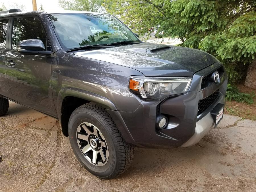

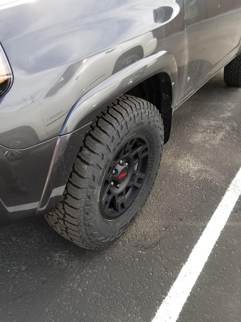

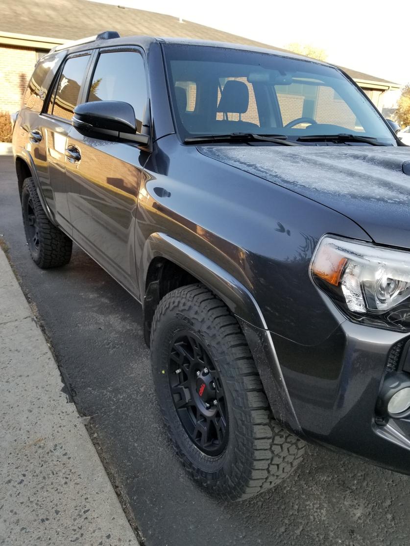

Before:
After:
Close-up:
Super happy with the looks and handling characteristics!
