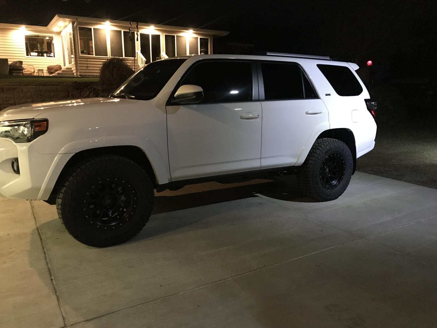

275s on scs ray10s
Couldnt wait any longer decided to mount the tires up lastnight! Lift should be showing up any day.. but actually they dnt rub that bad at all just barley catches the front bumper when turning full lock. Super happy with the wildpeaks so far

Def crazy u had that much rubbing with 265s.. goes to show u each rig is diff.. im still shocked the 275s dnt rub on my wifes 19 (except full lock in reverse) still waiting for my lift to show up though
