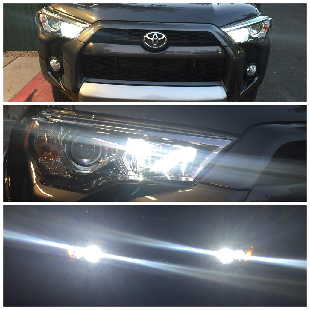

here is a couple snaps I took earlier of the DRL's they are extremely bright haha.
The top two are just the DRL's and the bottom is the High Beam.
There is a very slight vibration in the light, but its barely noticeable. I had to really look at it to find a flaw. But it doesn't bother me whatsoever, just thought i'd mention so others would be aware.
