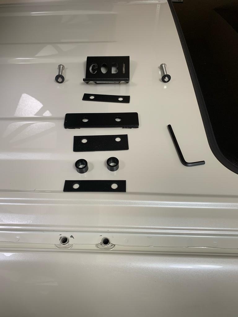

I plan to clay bar the roof and give it a nice wax before throwing on the rack. I'm just not 100% sure what to use to seal the holes on the roof. I've read about Butyl, RTV silicone, some people don't put anything but the seals provided with the rack...

Gobi provides some good rubber seals. Each bolt essentially has 4 layers of seal between the bolt head and the threads.

I followed the gobi instructions and only used the included rubber seals. I didn’t use any sealants or silicone. no leaks.

I concur that you just need to use what Gobi offers and use no sealant. I didn't add any and I live in Portland, OR where I see a lot of rain, and my rig isn't kept in the garage either. No leaks whatsoever.

I would not use RTV for any reason.
"The most commonly used RTV silicones are acetoxy cure silicone and neutral cure (oxime) silicone. Acetoxy cure silicone has a relatively fast curing rate and a short tack-free time, providing a good, quality adhesion, although it is corrosive to metals. This type of RTV silicone releases acidic acid, producing a vinegar smell as a by-product."
Gobi provided seals, plus either butyl rubber or Sikaflex 221 would be best.
Water intrusion thru the roof rack bolt holes is very subtle, the way you'll know is if you pull the seat belts out to the stops and you'll find it's wet/damp.
It doesn't touch metal if you apply it under the seals. It contacts with paint, plastic, and rubber.
Plenty of info out there on RTV - it has acid in it- paint wont protect it - it will etch your paint over time, which then leads to rust. It is simply the wrong product for the application.
