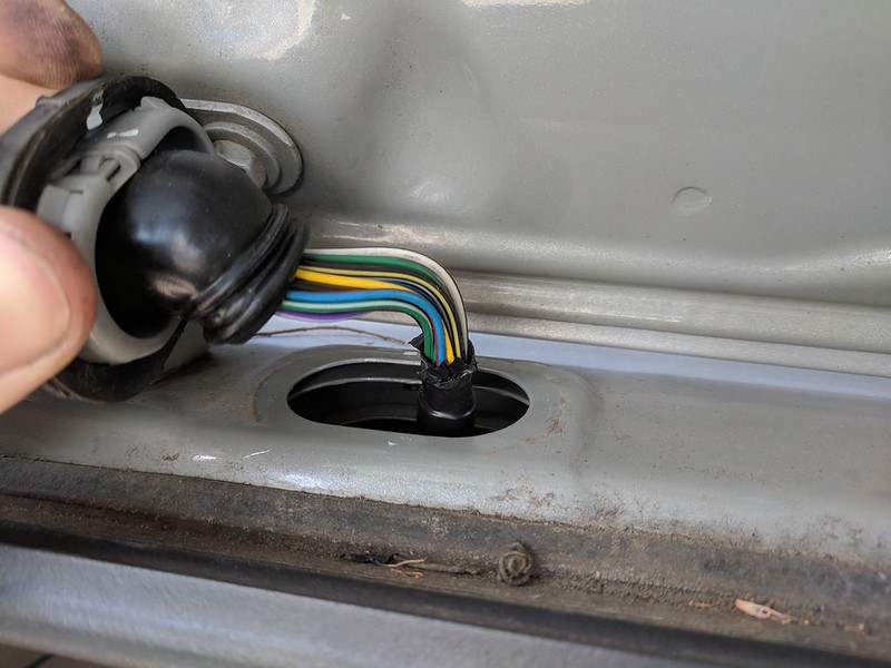

when i had this issue it was caused by the door lock locator on the rear gate. Apparently, part of the lock cylinder includes an electronic cap that tells the car the physical location of the lock, so the car knows if the doors are in the locked or open position. Well, my rear gate lock cylinder was a little askew in the bezel from me forcing it with the key. Because the lock cylinder was askew, just a little, it confused the electronic lock locator causing the ghost locking and unlocking. It was a real issue and I had no control over the locks at all. Finally, to solve the issue I removed the rear lift gate lock cylinder and it solved the problem 100%. The lock cylinder is plugged into a wire harness and it can simply be removed and unplugged. I no longer have a rear gate key cylinder put it still locks and unlocks with the rest of the doors.
I had this same problem with the front drivers door. I replaced that electronic cap with a new Toyota part and no more ghost locks/unlocks.

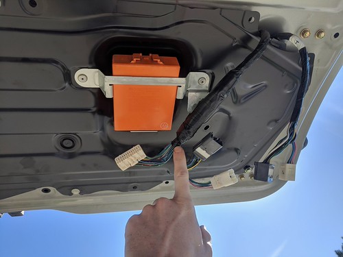

Bumping an old thread but just started happening to me tonight. It's the weirdest thing - all of the sudden the locks kept trying to unlock and the rear window would roll down randomly. Sometimes I would try to roll the rear window up and it would be completely unresponsive. Does't matter if the car is running or the key is in the ignition. Pulled the battery out of the fob with not change. Ended up pulling the power lock fuse to stop them from actuating. Because it is the door locks AND the rear window I am leaning towards an issue with the rear door lock. Will take apart tomorrow and investigate.
New symptom - When I turn the ignition the door lock as they should but immediately unlock. Its similar to when you try to lock your doors with the keys in the ignition. I am still leaning toward the rear power window relay as the culprit because when I unplug it everything works as it should (except my ability to roll the rear window obviously).
Toyota wants $500 for a new one and of course they are non returnable. Going to try the local pick and pulls first.

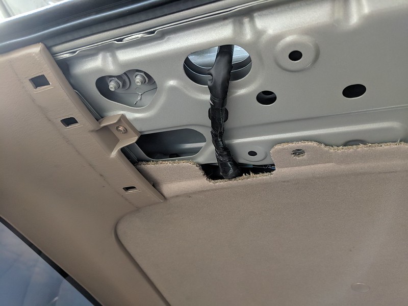

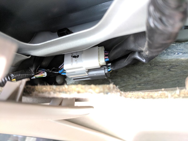

Turn 180 and inspect harness to rear door at upper left . Easy to pull interior panel trim at headliner. Unplug connector and fish it out,peel insulation back and look for harness damage

The wires and connectors all appear to be in perfect shape. Any other thoughts?
Try a wiggle test with key on, switches as well it will be "tough" without a helper.
Harness does look good..but best to test it.
