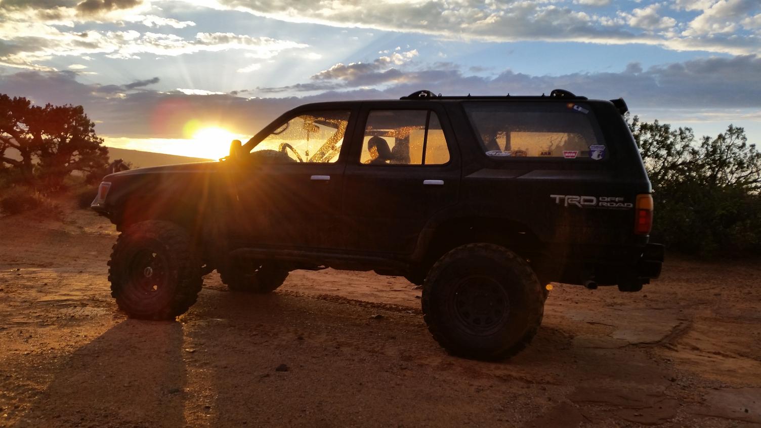

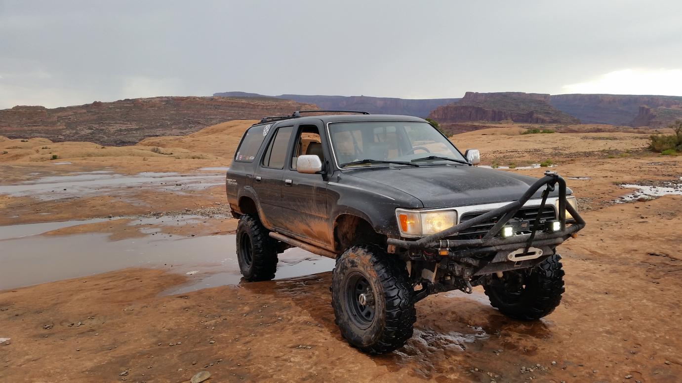

I'm pretty new here and got a 94 manual 4Runner already on its way to be a decent rock crawler. All the current mods were done by the previous owner other than I've added some Rigid lights to the front. The head gasket is blown now and instead of fixing and rebuilding I'm going with a 350 swap, but I've found plenty of information on that. What I can't really find is what I need as far as suspension components to try to match the front to the rear when doing an SAS swap which I plan on doing either while the engine is out or soon after, depending how long it takes me to finish the engine.
It currently has a 7.5" lift with front and rear spartan lockers. I'm not sure what the previous owner said exactly about the rear suspension, but it has some parts from a Landcruiser to overcome the rear sag.
I'm a welder fabricator and a prior flight engineer and have plenty of mechanical experience, but it's mostly engine, electrical and fuel type of experience. I am pretty new to suspension and drivetrain. I'd like to keep my 7.5" lift, but all the swap kits seem to only go to 5". Can I keep portions of my original suspension to maintain the lift? I'm already going to add the 2" body lift for my engine swap. Any general information that I might need to know would be greatly appreciated.

The only thing you'll need to match the front and rear is wheel spacers in the front as the solid front axles are narrower. Unless you plan on leaf springing the rear then the 63" chevy swap is a good way to go. Plenty of write-ups here and on yotatech on both of those projects. Nice rig by the way. Going to be a beast with a SBC in it.
Also not sure what type of wheeling you plan on doing but if you have to put a 2"BL on I'd be careful with how much suspension you run. That tall of a vehicle will be tipsy. Is think if you want it to stay about the same height then a 2" BL then the 5" swap kit will be good then just do what ya gotta do in the rear to match.

7.5" lift??? That's, what, a 4" bracket lift, 1.5" wheel spacers and the torsion bars about cranked out, that might get you there. I don't know what sort of Landcruiser coils he put in the rear, but I think they give 3-4 inches so there's probably a thick spacer in there, and then I dunno.
Are you sure that's a 7.5" lift? It doesn't look that high, and if it is I don't know how he did it. That's way too tall to be stable, at least at stock width. If you're willing to trim sheet metal, 3-4 inches is all you need to clear 35s, and a 4Runner on 35s with a solid axle is a mean crawling machine.
