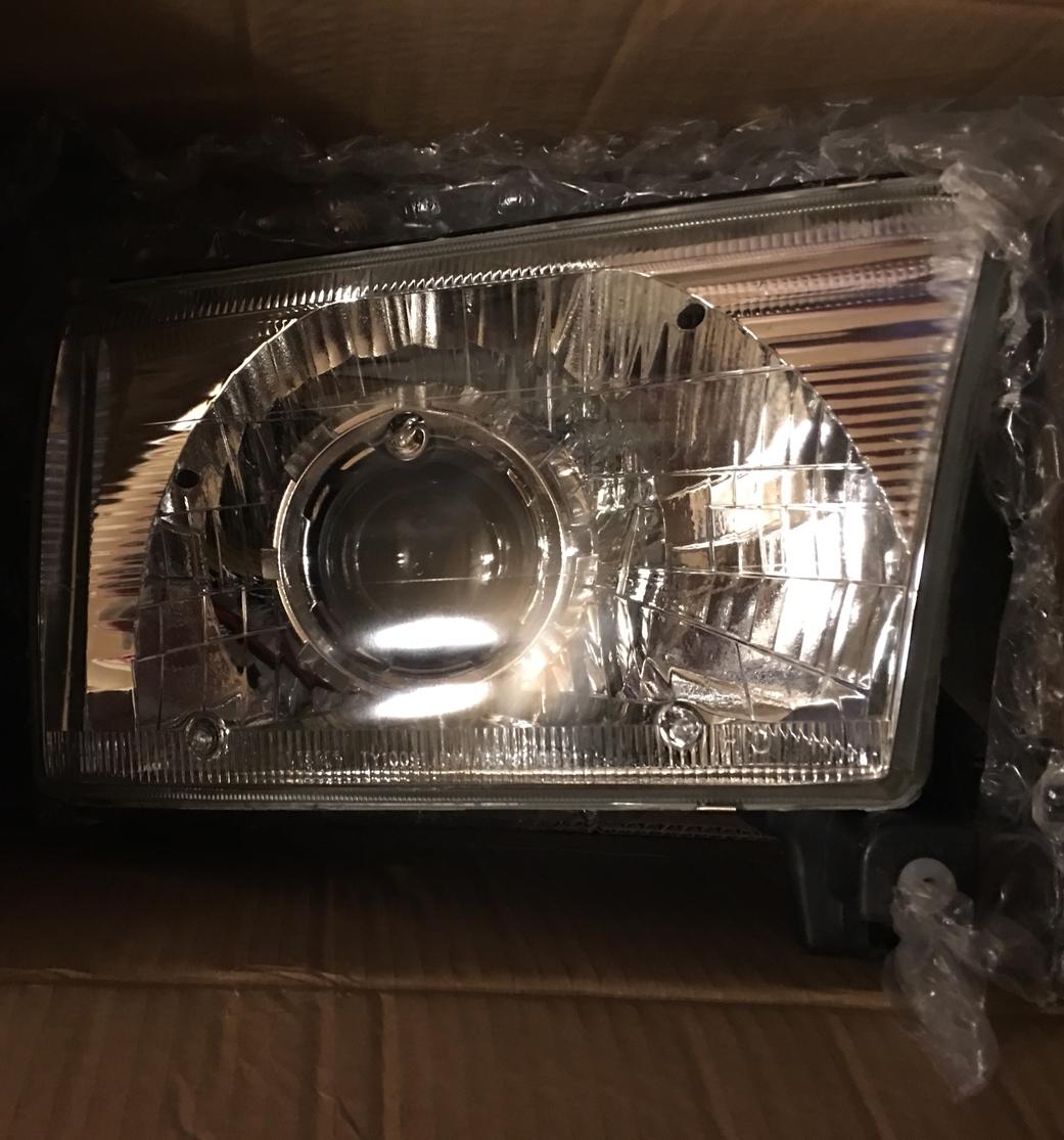

The light output of the stock halogens is horrendous. Good time to get a retrofit. I have this brand new set with H1 projectors, 35w bulbs and ballasts, harness, hidden LED halos behind the Gatling gun shrouds just sitting in my garage. I will post it for sale in a bit.
JMHO here: Don't know the price nor who did this retrofit, but man you should really consider this. HIDs are da bomb.
