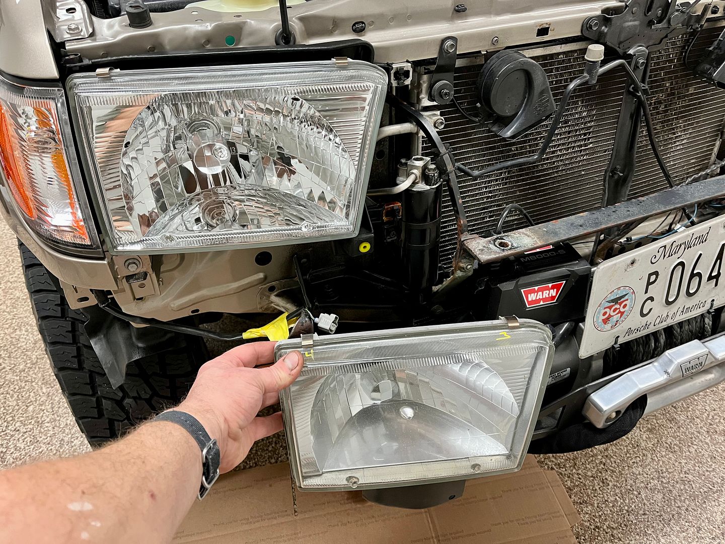

Exactly what I did a few months ago. They make a world of difference. That said, I kept my original, sandblasted 520,000-mile headlights.

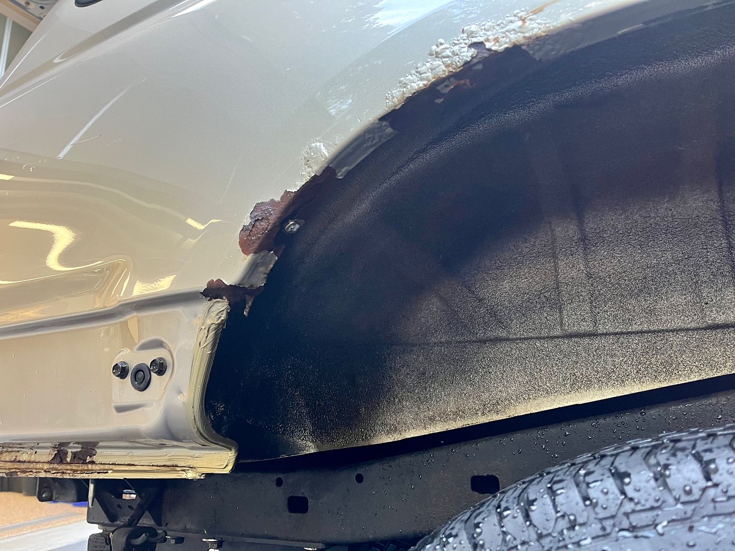

I kept it in really nice shape for 21+ years (bought it new), but the rear wheel arches started showing rust a while ago, so at the end of last year I stripped everything off the truck and took it to a bodyshop in PA. It was gone for three months - the rust was cut out, new sheetmetal was formed, other rust was found, and eventually both fenders & hood were replaced with new Toyota parts. Along with the usual dents & dings. It became a full glass-out respray.
The truck had never been wrecked, and I've made sure the frame was in good shape over the years.

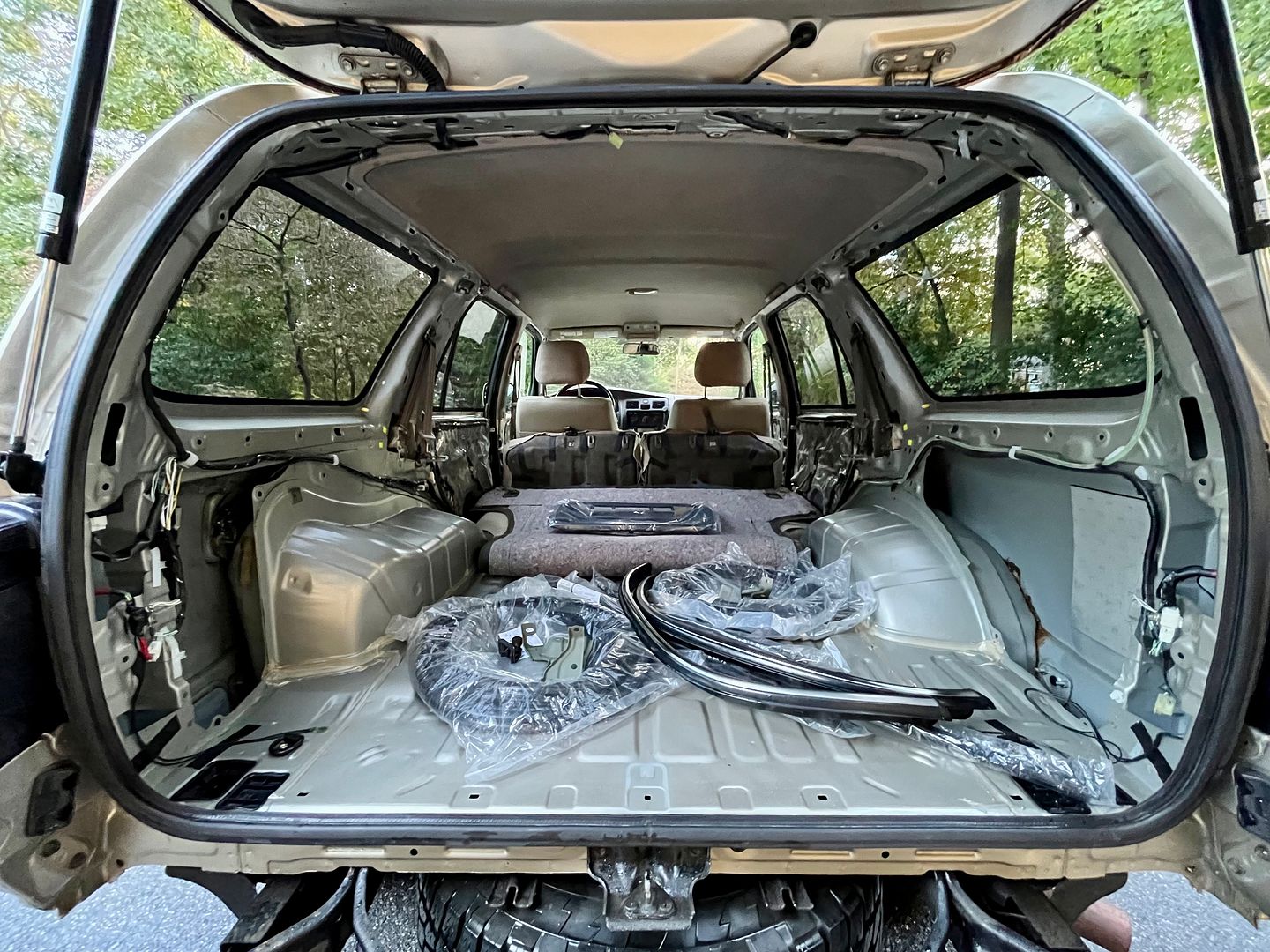

I picked the truck up in late January and spent about a month going through everything, refinishing parts, and reassembling it. That was a long process....
