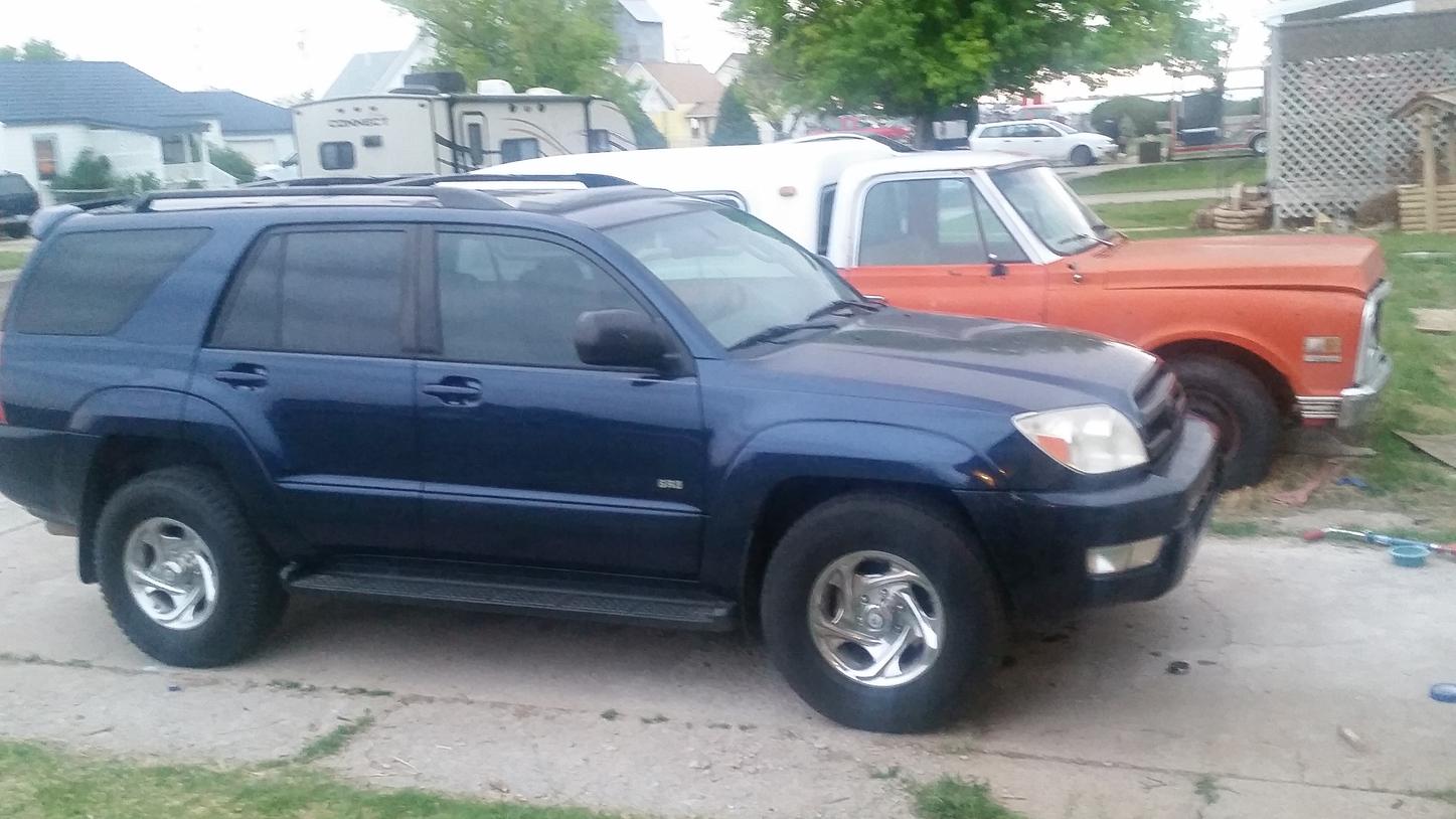

Hello everyone for time on t4r just bought by first 4 runner last Wednesday! It's an 04 sr5 2wd and I'm really happy with it unfortunately I'm already having problems with it one that I'm sure of and the other problem I'm not sure where to start with thought I was getting a good deal from a local used car lot but I'm not so sure of it now. Now here are my problems 1st I popped a cell for a number 6 cyl misfire changed plugs like every one seems to do cleared the code with my obdll drove fine for 2 days then started it Friday when we where going to head out of town for denver and it idled rough for a bit then clear up so went ahead and the family and I took our trip had a good time and didn't have much problems but I notice it used a little coolent Google the problem and ford out about the dreaded number 6 cyl head gasket problem so I might just go ahead and change both head gaskets when I get to that point
Okay problem number 2! It has to do with the transmission "I think" so so I figures since this 4 runner has a 4 speed with od it would run lower rpm at highway speed I was turning about 3k + or - 100 rpm at 65mph is that normal??? Second part is that when I go to pass and I hit the kick down accelerator it jumps to 6 k rpm and just keeps going till red line unless I let of and pedal it a bit and get back in it then it will go down to about 5 k and that just don't seem right to me at all what could the problem be??? Ihave been trying to find something on t4r that has came close but to no avail I was thinking of the guy I bought iflt from put in a regular type of at instead of the type lv at that toyota recommends could that cause and issue?? Is my tranny slipping idk where to begin on this one is there a way to change the shift points or adjust the line pressure? I'm a pretty mechanical guy and know my way around cars but the is is my first foreign truck and just all seems well foreign to me or if I'm thin li ng in the right direction?? I would really appreciate and insight on my problem that any of you gents might have
