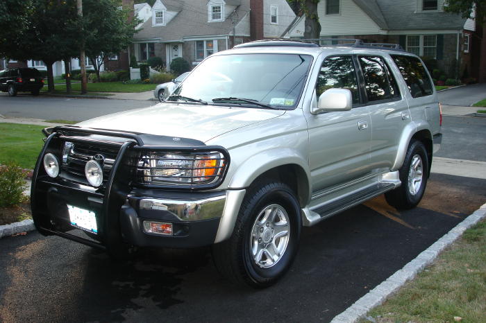

Im new here but Ive had my 4 Runner for about a year. It is a 2002 SR5. I havent really done much with it except for the front lights and a new stereo.

Here is a pic:

1) Yes, 9/10 times you will have no rubbing issues either, small chance depending on tire
2) You can put the 99 springs for an inch of lift without any mods at all. Yes, to be safe I would get an alignment just to save your tires.
Welcome to the boards, also try www.yotatech.com/f2 for more tech information. good luck!
so if i run 265/75/16 and remove my running boards i should be good for mine? my runner is basically used for street with an occasional offroad trip (no mud or snow though)
i know my model is the "low rider" so i was curious about this as well
yup, most can run them with the running boards but for extra assurance take em off, and plus they look like doo doo once the mods start going on
