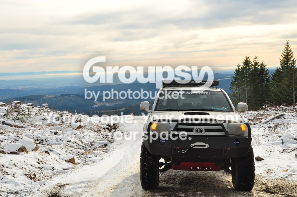

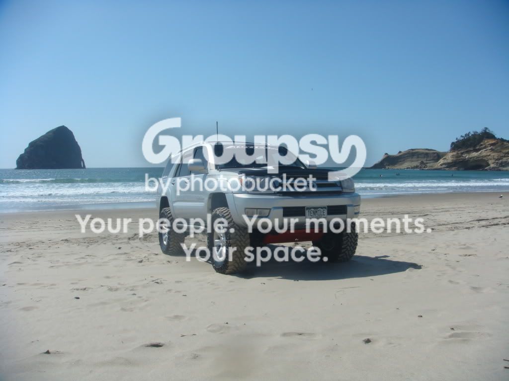

Here is my 4Runner with 35s and 17" stock rims.
OregonCoastRoadTrip129.jpg~original
and a crappy cell phone pic with the bumper.
Beaverton-Hillsboro-20110625-00101.jpg~original

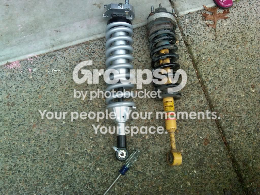

I went with the 2.5 Overland Warehouse COs because they are beefy. Here they are compared to the Bilstein stock with spacer lift.
IMG00103-20110205-1051.jpg~original
I also went with the 2.5s because they will hold the weight of the bumper much better.

Yes. It is a dog. Ill regear eventually
That 4runner looks BA.....
O.k I at least know it is possible to run them. Now how does it perform in the trails? I will regear since I was running 4.88's on my TLC
How much does that suspension run for aprox? I will have someone installing that know how to do it and I will help on that too. Kinda wanna prepare myself. Is that a complete kit? Or do I have to purchase parts by parts?
Thanks again.

The lift is expensive. Here is the package.
Full 2.5" suspension kit

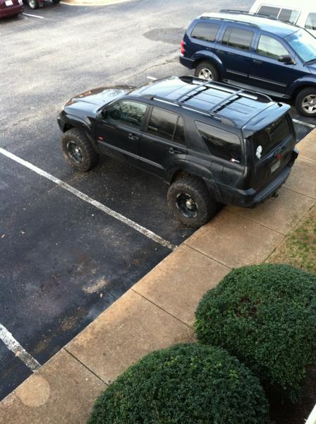

what all trimming do you have to do to put the 35s on i have 35in mud grapplers already. my lifts are a 3/2 revtech and 1in BL FROM toyotech. what do i need to do to put them on without alot of scrubbing
hey guys i cant figure out how to post threads so i figured id post on this one
i got a 2005 4runner with 3/2 revtech lift and a toyotech 1 inch body lift and
im running 35s with basically no trouble its alittle harder to park but that the
only difference basically i had to trim a good bit but cant really tell i also
have 2inch spacers

Haha dang!! Spacers? Wheels? That offset is huge! Those swampers are good but too knobby for me but still looks sick man
haha yea i like the offset. makes it look real mean. but yea with the offset and mudgrapplers i can never keep it clean haha
Are you rubbing any on your runner .. What's you gas mpg...your toyos should be a lot skinnier... I only rub when I park or really sharp turns

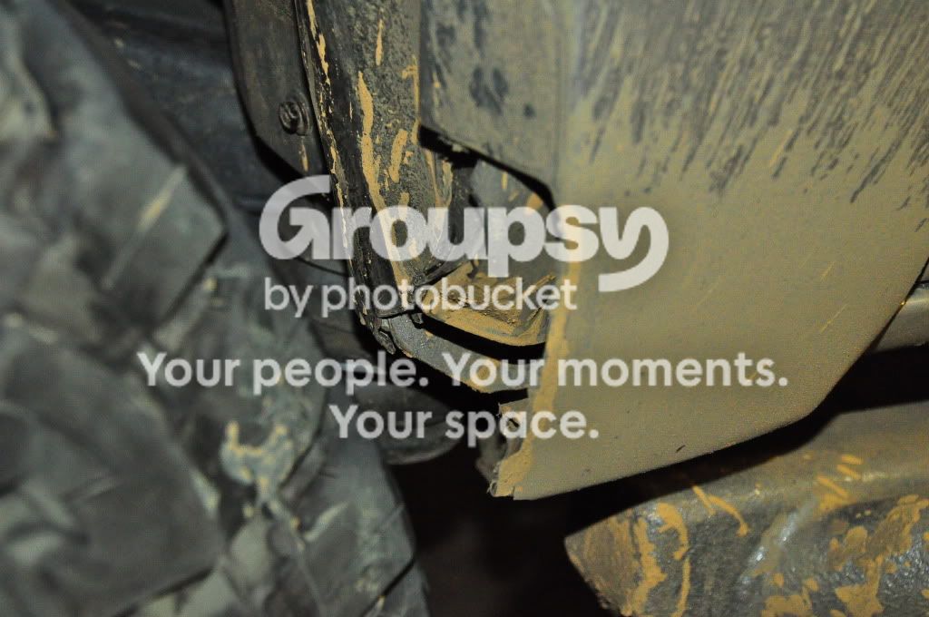

I dont rub anymore. With my bumper and some trimming im rub free. Complete lock on turns too!
Trimmed here:
DSC_0318.jpg~original

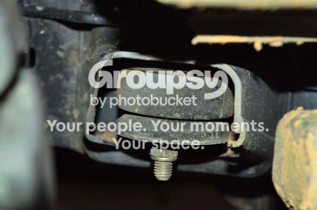

And the Body mount:
DSC_0319.jpg~original
And no rubbing with the front bumper!
DSC_0217.jpg~original
Yea the only place I rub it on my body mount but I was scared to cut it haha ... What did you us to cut it??
