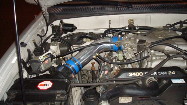

So I did the Isr mod and i was happy i also did the deck plate mod and i was happier. I The quest for greatness i did another mod. Total cost was 66 dollars. I bought a 3" intercooler pipe kit on ebay and made a new intake pipe. It was 60+ shipping but here is the great part i have so much pipe left over i am going to do my girlfriends 06 xterra. intake cost for her truck is over three hundred.

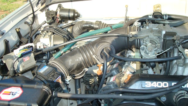

search isr mod and deck plate mod on this forum. Here is a pic of the deck plate mod

You know, I been thinking about doing the ISR mod. But I wanted someone to tell me exactly how hard it is, and if I will even be able to tell a difference. Any comments?
The isr mod is super easy. just follow the instructions i think it took me 15-20 mins

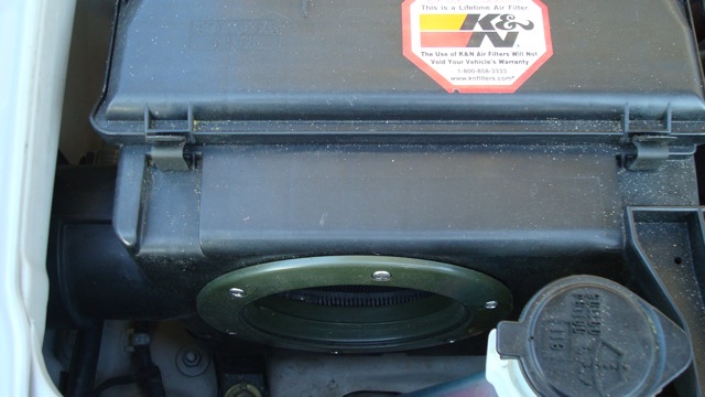

this is what it should look like when you are done.
the new intake pipe that i replaces the isr mod and looks pretty too

Thanks, I did this on my Legacy GT, So you need a pipe for the ISR mod?
Edit: Sorry I just went out and looked at my truck... I see what has to be done. I didn't realize the silencer was inline. The Legacy was attached to the bottom of the air box.
That looks good, did you only have to cut the pipe and it had the bungs already there for the smaller tubes? If so I want to know where you bought it. (the auctioner on ebay)
Like, it has the correct bend and everything to make the install look clean.
The bend was there and i had to add the nipples for the other vacuum lines. Home depot sells them they are like a 1 and change each. Drilled the holes with a uni bit and threaded it with my trusty tap and die set. used jeld weld to seal them so there are no vacuum leaks.
