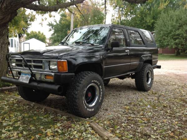

Hello everybody! I just purchased an 1986 auto, and as I initially thought it was a steal at $2k with 130000 miles, I drove it home and immediately realized it almost certainly has a blown HG... I'm kicking myself for not spending a bit more time with the vehicle before purchase but what's done is done. I'm a bit excited to do the work, but I'm concerned that more damage to the engine was done, as I don't know how long the vehicle had been driven in it's current state. The temp gauge on the drive home showed normal, but I'm not sure where the sender is located, so I'm worried the coolant was gummed up from oil and maybe not flowing properly (please let me know if my suspicions are unfounded) and the oil pressure gauge was low the entire trip home (registering, but low) -- I had ignorantly assumed it was the oil temperature....
So sorry to start my first post so sorely, Do you all think there are any grounds for my concerns for further engine damage, and what would be the best way to assess?

Welcome aboard. Diggin those 'tube' bumpers! Don't worry about the oil pressure being low, that's normal.
