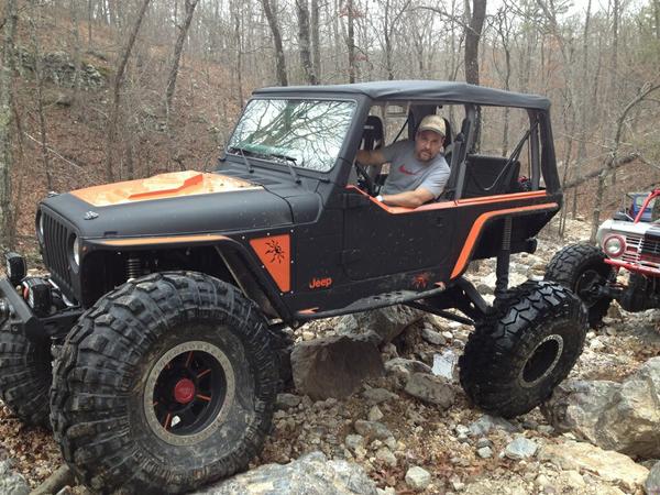

Now, don't get upset with me. But, I am also fond of Jeeps and have built three crawlers. Here is my latest.
