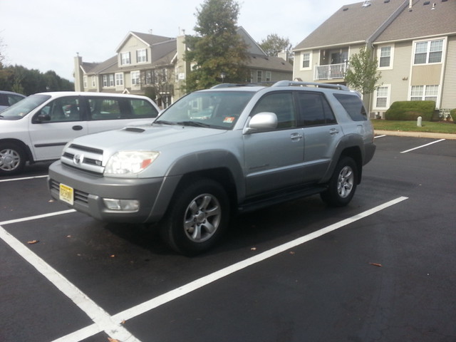

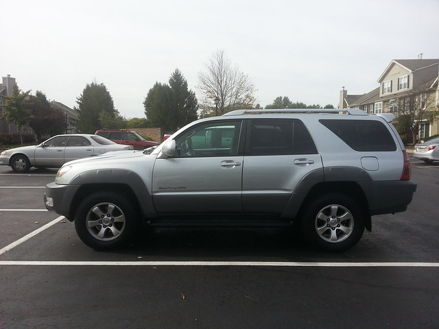

I've been lurking the forum for a while now and finally purchased a 2003 sports edition V8 4 runner. I planned on putting on some Daystar leveling kit but when I took the 4runner to service, I found out that the 2 rear shocks have rusted through and needs to be replaced :violin:
So here comes the noob question, what are the best after market shocks and when replaced, do i need to do anything about the X-REAS system or does it work with aftermarket shocks or do i have to take them out.
I do plan on doing some mild off-roading.
Thanks and glad to be a part of the community.
