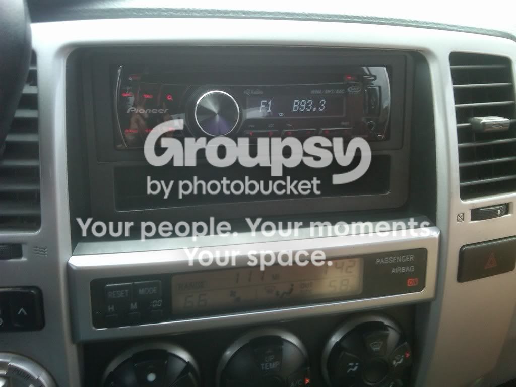

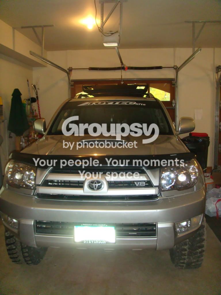

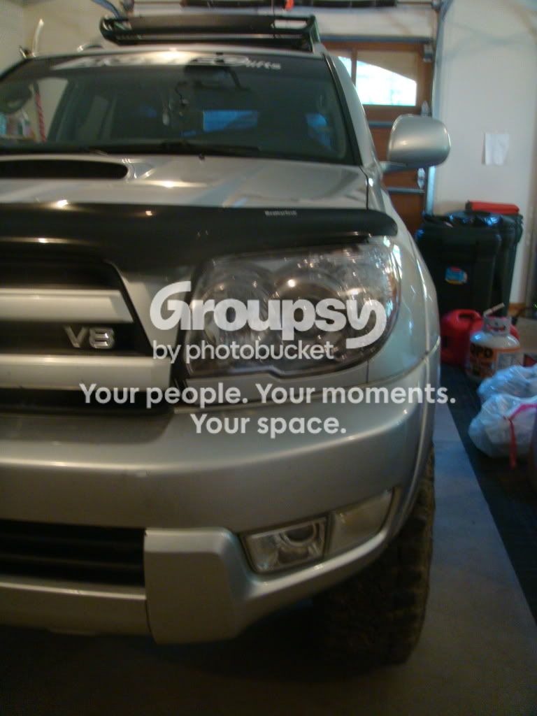

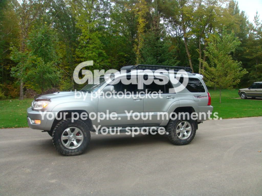

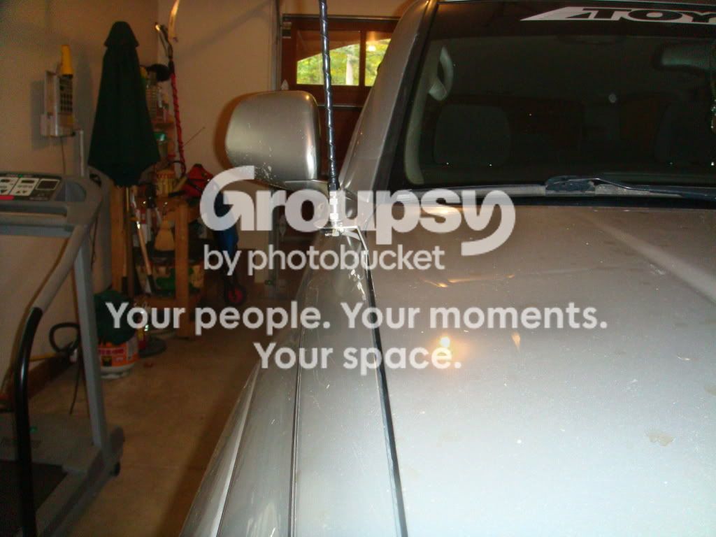

Done a few Mods lately! And some more to come!
So far I have added the roof rack, 06+ Projectors, CB antenna, and a new Head Unit.

Nice looking runner! What rack is that you went with? I want to add one to mine and am confused about what to get...just like every other mod! :confused:

Price was a big thing. If I could I would get the Gobi but I just dont have that money right now so I went with the Rola rack from etrailer.com. I love it! It's still really low profile and very sturdy! And the wind noise is non existant! Highly suggest! :thumb3:

Yes, all you need is the headlight and the trim piece.
No "bulb out" warnings
You do lose your parking lights on (the small amber light in the headlights) but I'm going to try and fab something up where I can get my parking lights on.
I've been thinking of doing the 06+ headlights, where did you get them?
I've been searching ebay, nobody sells the 06+ in a set it seems. All Left side, or right side etc. Don't want to pay shipping twice on them :redbrick:
I went with this ebay listing 2006 2007 Toyota 4Runner Sport Headlight Head Lamp : eBay Motors (item 140453987940 end time Sep-19-10 21:00:36 PDT) with FREE SHIPPING!! :bigok:

They use a H11 bulb so yes you do have to cut wires. But what I did is order a 5000k HID kit from DDM tunning and so I cut those wires instead of my stock headlight wires so I can go back to stock if I ever wanted to.
