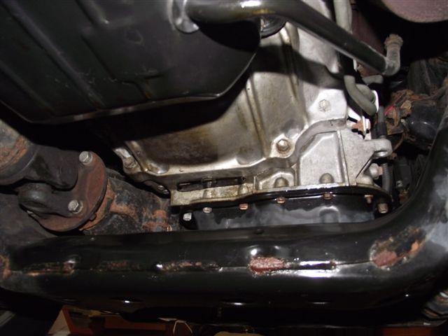

Heres a rough picture of whats going on. The rear of the pan is wet, the front is not. The only other place I think oil could be coming from is that little platic cover just to the left and above the oil pan. Not sure what that is but its not made to seal oil.
Its amazing how much of a mess a little oil can make. When I'm driving it starts accumulating on the skid plate then it blows to the cross member then starts dripping on the driveway. When its parked it dosent leak at all. I checked the level and I'm estimating it to be only a quart low (just below the the top dot on the dipstick).

I think I found the leak and its NOT the pan gasket. I finally decided to remove that plastic cover near the oil pan and discovered oil inside. I started to car and climbed under to have a look. Sure enough oil is seeping around one of the two bolt heads. :eek:
I also notied theres a belt spinning in there. Im assuming this must be the oil pump. I am going to try and tighten the bolt but I have a bad feeling that isnt going to solve my ever more expensive problem.

Good Catch sr5hi And Find 101 !! I doubt it’s an oil pump outside of the oil pan (or it will be a first for me to hear of or see). Please send a better shot of the part under the white cover showing the bolts that’s seeping. Plus, I’m sure you know by now what the part is and problem is.

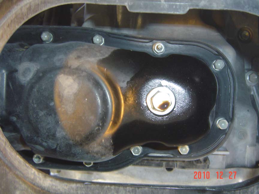

I believe I saw that smaller drain pan with the oil drain plug that looked easy to get to through the skid etc. I said and saw that c/n be the oil pan on the block due to the small shape. This should b an interesting report. 1. Is the purpose of two pans a deeper sump to prevent starvation while climbing? 2. What was the leaking part behind the white plastic cover with belts? If anyone know of a link that will show these parts, Please Share!
BTW, my lower pan was wet (attached) when I inspected the T4R after purchasing (12/2010) the 07 V6 2WD. I slightly snugged the oil drain plug to solve that. I ordered 2 new crush washers/gaskets etc to add during this week’s oil change.

It's a black plastic cover. When you pull it off is exposes 2 bolt heads the are holding the upper oil pan to the engine block. This is where my leak is happening. I'm not sure what causes the leak other then old age...

Those two bolts are above the "upper oil pan." According to my mechanic at the time you have to drop the lower and upper oil pan to get to the leak. Which also involves dropping the front differential. No sure exactly what they did while they had it apart but it did stop leaking from that spot when they were done.
