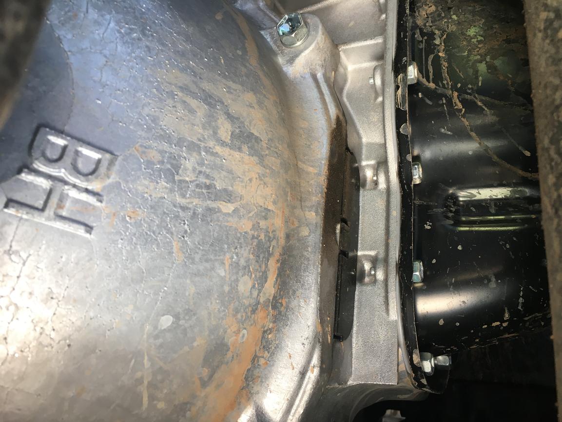

Sorry about the picture orientation. Looks like this is the right thread based on my suspected leak issue. I'm pretty sure if I pull the black plastic cover I'll find the passenger side bolt is leaking. I'm at 8K miles on my 2016. This has to be a record premature leak:rain::rain:
I'm sure the dealer will tell me it's normal and not to worry about it. I'll monitor and post another follow-up in a few months.

I too have the same leak. I got under there today and tried to spot where it was coming from. I removed the plastic cover and felt air being blown out (like oil vapor from a crankcase vent) and air being sucked in on the other side as can be seen in the pic above. One side of the plastic cover is wet and the other is not. Does anyone know if there is a PCV vent there or something?
meant to quote this pic for my above post. Anyone have a pic of the back of the motor without the flexplate on?
Its been 4 months with no leaks.
