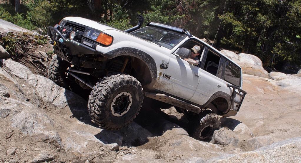

My real "Trail Rig" shown below... The Runner is my DD / fire road runner, until the odometer get north of 100K... But I'm more than halfway there, just did my 60K service last weekend...

Lol. I thought that name sounded familiar. It's fun to wheel the 80 and the runner though. The runner is not going to be as sweet as your 80 but for dd, it's a great rig.
Ya... I guess someone else has "AMMO" so tossing "Trail" in front seemed like a logical choice :-)
Love the runner for DD and family "camping / exploring"... Funny cause when we were in OR the 80 was more expo.... Now down here with actual trails, the 80 went back to "trail duty" and the runner became the get outta down runner :-)
See ya back on mud!
-Matt
