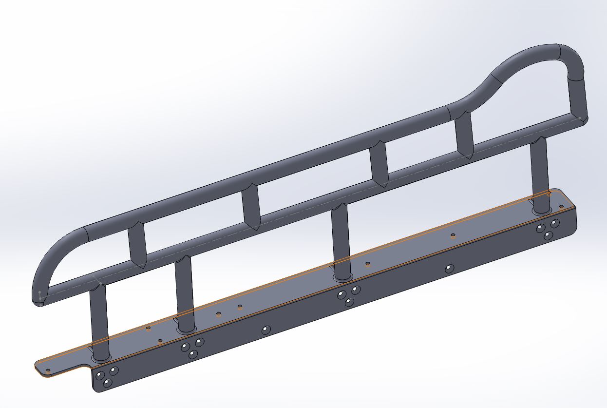

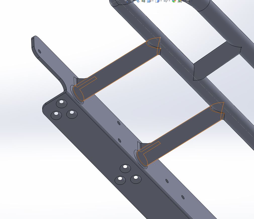

I believe the two bottom bolts on the lower part of the frame are a relatively simple attempt to relieve the torsional stress of the arm bending upwards and warping the full length mounting plate away from the frame at the 3 legs. Note that the factory m10 fastener points are not located in the shear zone of the surrounding metal near the 3 welded on legs. Additionally, the gussets have minimal effect on vertical rigidity as they are not attached to any significant structure besides the undersized plate which only has 5 total fasteners to begin with. I find that attempting to "slide" over a rock with downward facing plates and 2 bolts sticking out is counterintuitive. The bolts may catch on a rock and spin the truck along its vertical axis and dump it on its roof, injuring or killing the driver and other occupants.

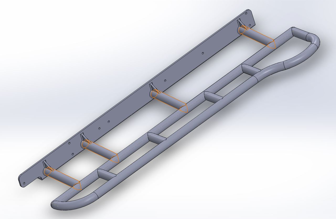

Instead of making 2 tabs which protrude off the frame, why not make the bottom of the flange full length and install 3 stainless rivnuts in a triangulated pattern directly on center with the 4 support legs in addition to the factory nutserts. The stainless 3/8 rivnuts each can handle a static shear load of 1520lbs. Since the rivnuts are 90 degrees to the axis of weight, a high percentage of the load on the rivnuts will be shear and very little axial pull. To stop from catching on a rock, the holes are chamfered for flat top countersunk stainless allen head 3/8 bolts.
Design is free for anyone who wants to use it. Editable Solidworks files available upon request. I realized I was kind of being a punk by offering only problems and no solutions.

I appreciate the change of heart man, this is the kind of helpful attitude that helps me and others learn! You sound like a smart guy, glad you could contribute your knowledge towards a mutual design improvement. I like the insight on shear vs axial loading of rivnuts under the frame, I always enjoy learning along the way.
