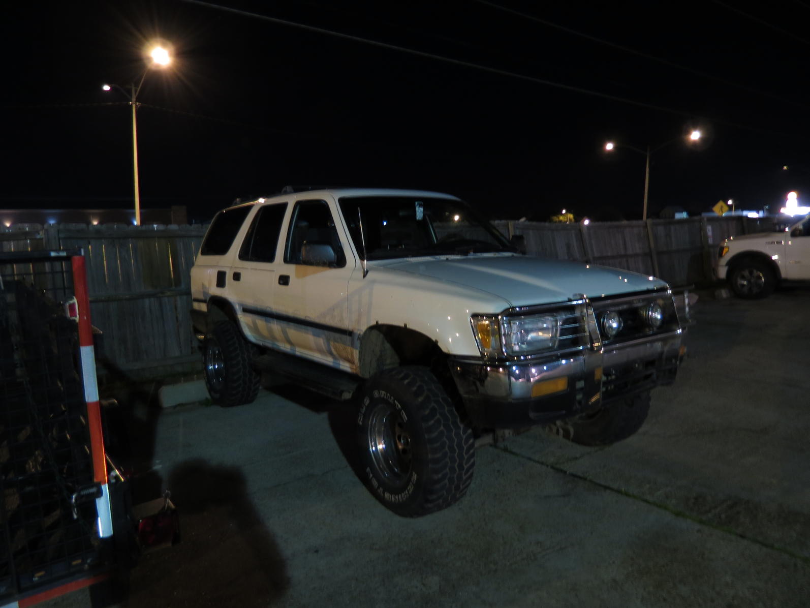

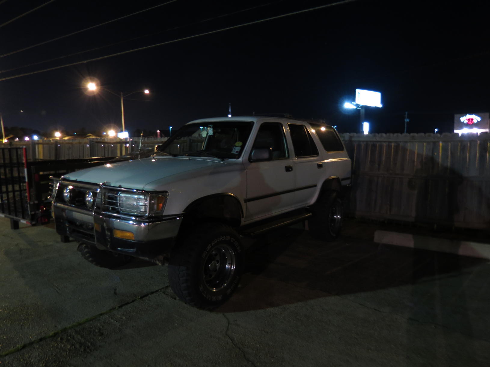

Also, here are a couple pics I took the night I brought it home. I will get better daylight pics when I get it back.
Orion
