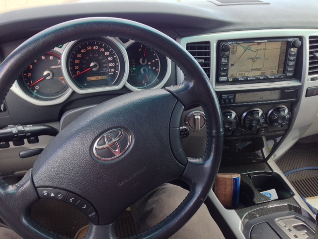

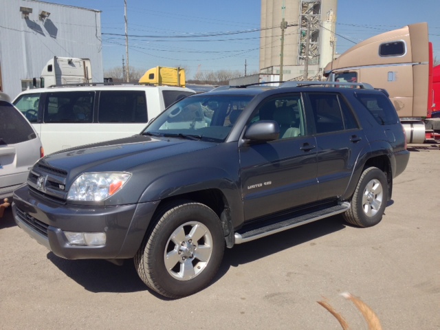

Hi All, I just picked up a 2004 4Runner Limited V8 w/NAV and so far it's great. 90,000 miles and looks and feels strong. I had it run through a 2 hour PPI at a Toyota dealership and they said everything looked really clean. I had a chance to get under the car and see for myself and besides some surface rust there was nothing I could see of any concern.
It has not had the 90k timing belt service so that is the big one...how long can these things go for in reality (safely) before the service? The Toyota mechanic told me up to 120,000 miles before I should seriously worry about it, but I don't plan on pressing my luck that much. I'd say I will enjoy it for about 5k until 95,000 and then do the service? It's also going to need front pads and possibly rotors, but I am not sure I entirely agree with the Toyota tech because he also said it needs new calipers? Unless there is an issue the calipers should not need replacing right?
Thanks in advance for all the forum help, I was originally wanted a V6 one but from reading up on here on some little issues and the negligible fuel econ difference once I found a solid 4Runner I pulled the trigger.
Full disclosure I paid $12,500. Good deal?

Congrats on the purchase! Great looking Runner.
