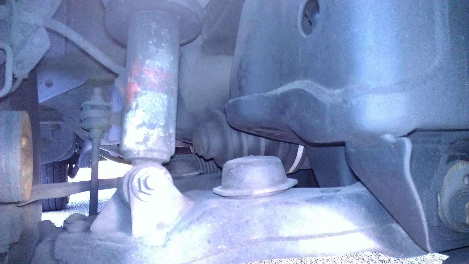

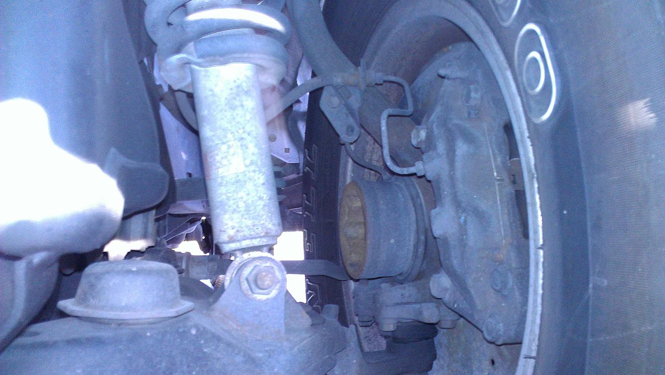

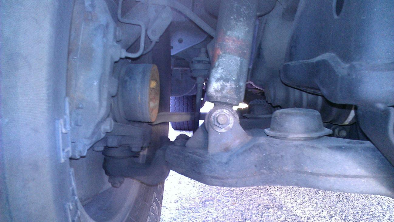

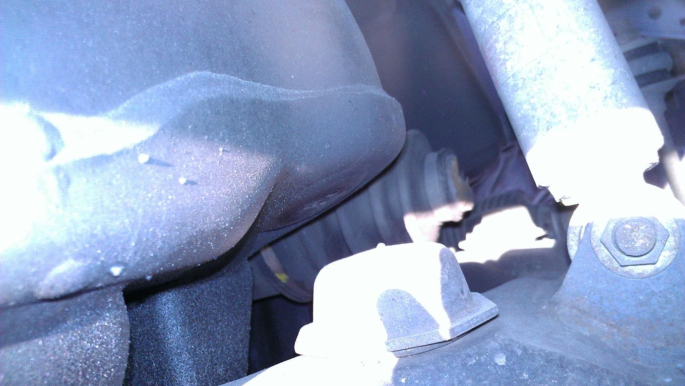

Hello all I have been here for a while researching and soaking as much info as possible. I was leaning towards a 4th gen but this 3rd gen came along...
this is a "4wd" limited. looks awesome on the outside not so nice on the inside, and well the front is missing some parts.. could you guys pitch in and tell me what I need to add to my missing 4wd?
thanks in advanced!
Here are the pics starting with drivers side
And passengers side
I can find part numbers, I just need an exact match from your description to the parts diagram. Ill also take part numbers along with a description...
Shoot I guess Ill take what I get! lol thanks in advanced

Looks like someone didn't like the 4WD so they cut the CVs, but to keep the diff from leaking they plugged them.
Could cause a BUNCH of problems.
The ADD system isn't designed to be driven on without the CVs in place. Could have ruined a bearing or something.
Kinda makes a person wonder about what condition that diff is in,
as in why the partial cv shafts?

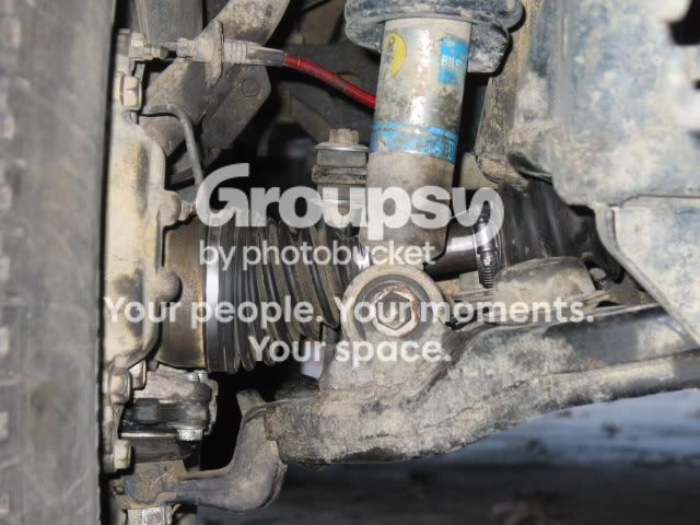

Pic of the left (driver) side:
IMG_0022.jpg~original

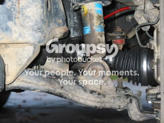

Right side:
IMG_0023.jpg~original
I have to ask: did you take a look under the 4runner before you bought it?
Nonetheless, $210 at NAPA for CVs and you should be OK. Draining and refilling the differential fluid would be a good idea as well as taking a close look at the lower ball joints.
Wow.. I really hope you didn't buy that runner. I could only imagine what else is missing/ wrong if they couldn't even get the cv's replaced. Any pics of under the hood? Ha
How much did you pay for this?
I'm also curious as if you even bothered to check the under carriage before buying this "2runner"

Thats an interesting solution to a leaking CV. At least the front diff's are usually cheap, if yours is even bad.
I bet there is something wrong with the front diff, it looks like the CVs were cut with a sawzall or something.
Damn, it never ceases to amaze me what unscrupulous used car dealers will do these day.s
Did they at least leave you the front drive shaft?
(runs next to left side of tranny, up to front diff)
