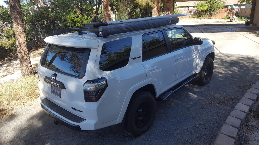

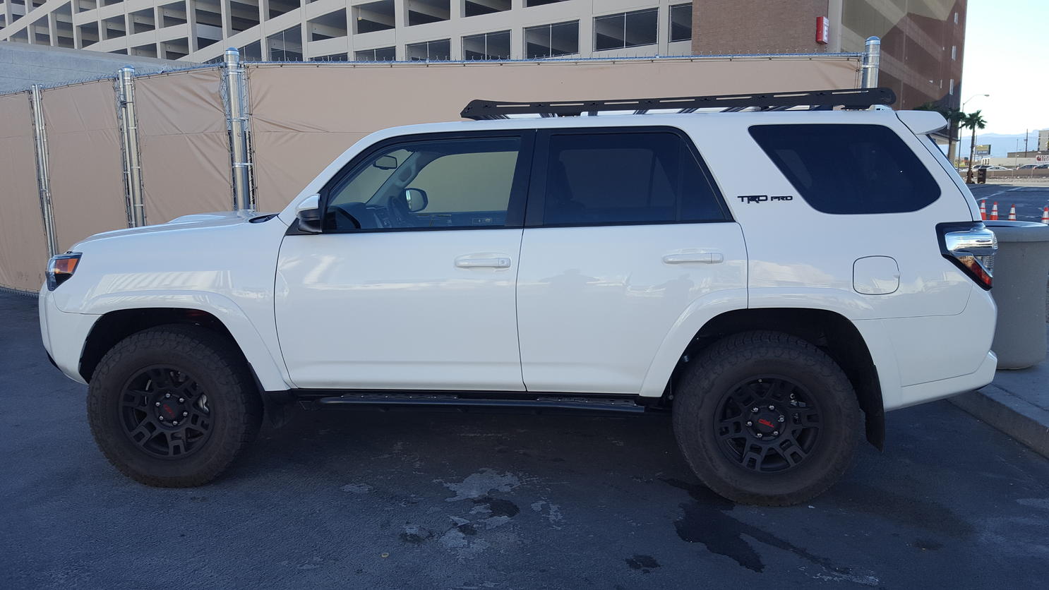

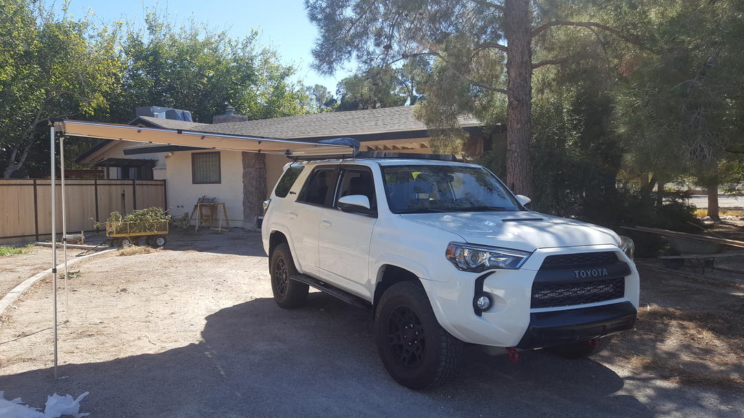

Finally installed my Prinsu 7/8 rack.

I love the look of Prinsu 7/8 roof rack. any noise issue at high speed?

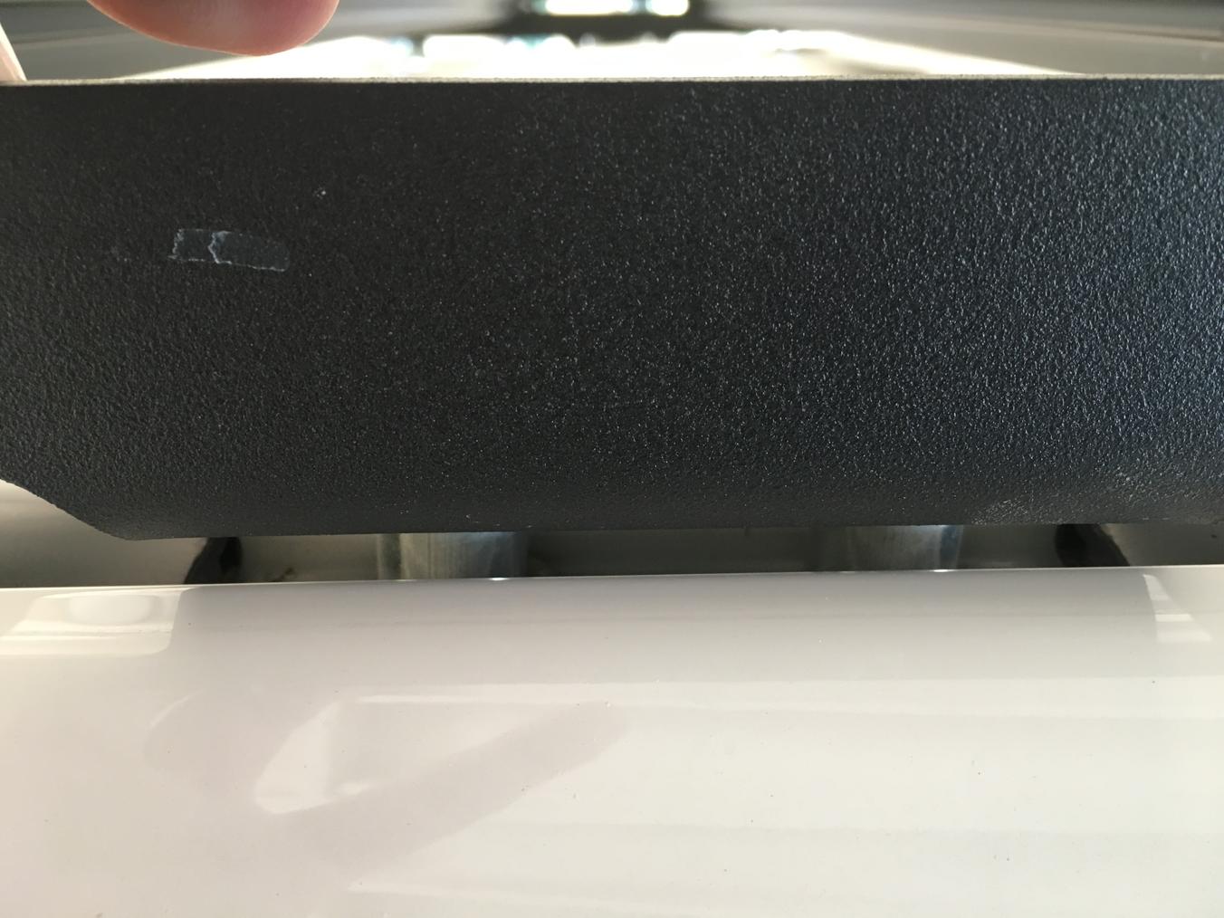

I haven't noticed any noise at all except the couple times when I was driving in 30 plus mph winds which I can't really attribute to the rack. I would take this with a little caution though because my hearing at some tones actually sucks so if wind noise falls within certain tones I wouldn't hear it anyways but my wife hasn't said anything about hearing anything either. If you trust the fuel mileage gauge, I only dropped .1 mpg's in the time it's been mounted which is great. I do wish the mounting spacers were designed a little different. I would like to see them make a one piece spacer that would fill the space between the rubber stripping where the stock rails were on the roof and maybe a rubber grommet for underneath it to help weather proof it along with the silicone. I would think a one piece design would help spread the weight of a loaded up rack over a larger surface area at the mounting points as well as look much nicer (the supplied spacers look kind of chintzy to me albeit they work ). I think the spacers should also be powder coated to match the side rails of the rack as well giving it a much more finished look.

Aside from wind noise I added a fender washer to each spacer as I notice one spacer shifter and was sitting at an angle and not flush with the rack feet. The fender washer leveled everything out.

You have the 3/4 rack if I remember correctly from another thread. I would think that yours would have less wind noise than mine. The only noise I get constantly that I really notice is the rattling of the carriage bolts I left in the channel for my awning mounts. I need to pull them out of there because you can’t tighten them up enough to keep them from rattling. I too had some spacers that didn’t sit quite flush with the rack base but they were close enough not for me to worry about it.
