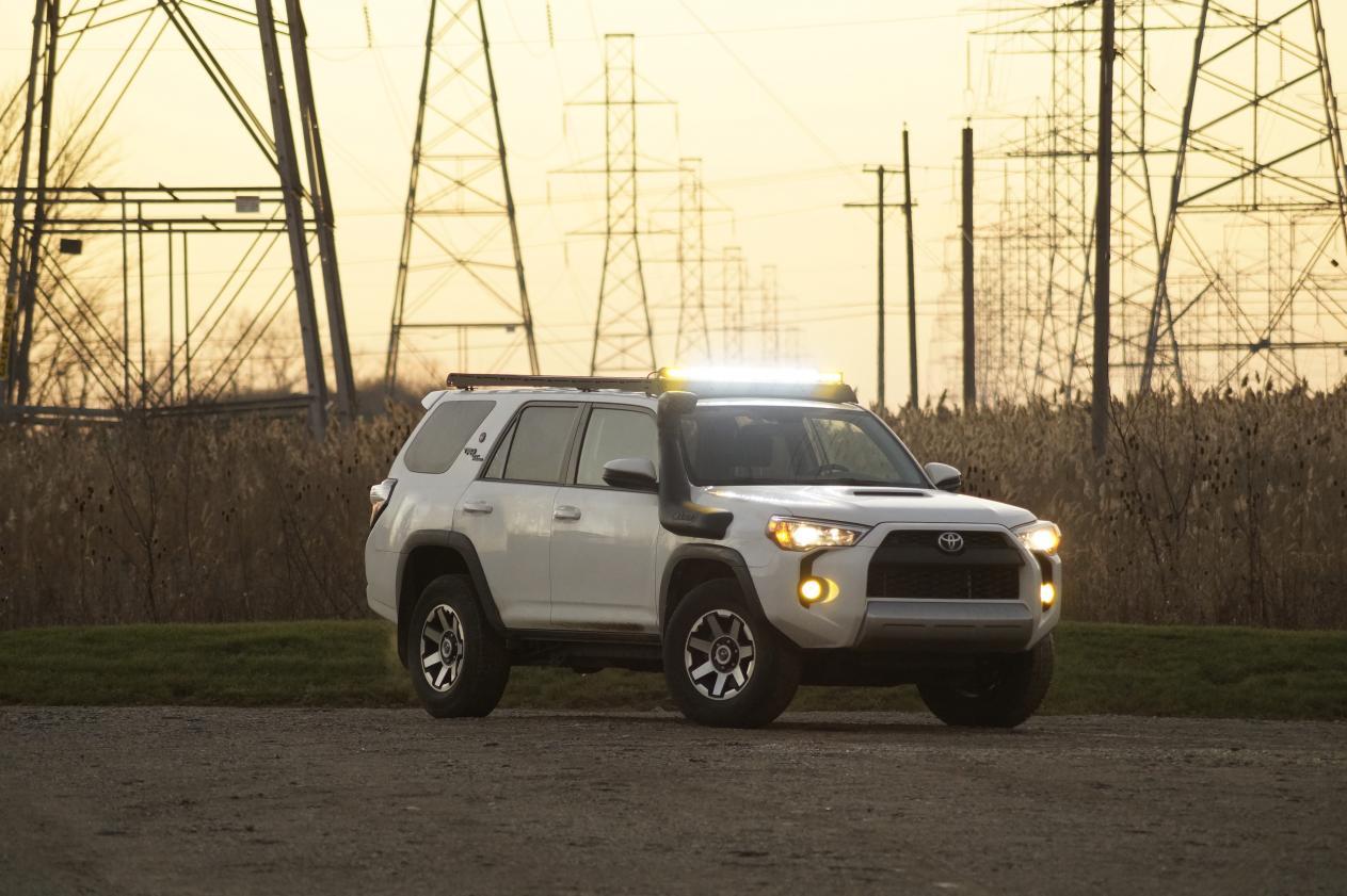

New full length prinsu roof rack
Got the new T4R5 prinsu no drill full length. it works pretty damn well

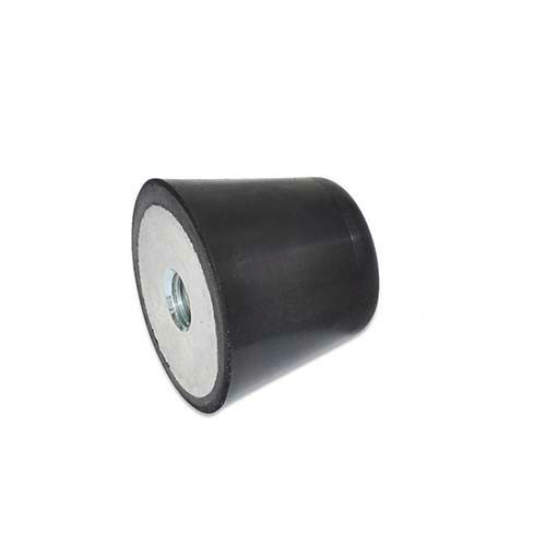

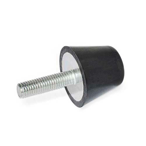

I snagged up the Prinsu full(drill) rack from another forum member (should arrive next week). I'm curious what other member's suggestions might be for bumper/footers to substitute in where you'd typically drill. Looking for something like this- I have yet to see how long they need to be. What would you suggest?
http://www.essentracomponents.com/e...dwich-mounts/single-end-female-sandwich-mount
Vibration Isolators and Vibration Control Products | Machine Leveling Mounts | J.W. Winco Vibration/Shock Absorption Mount, Conical, .63" H, 25 Max Load, 253-19-10X24-55 | B2216586 - GlobalIndustrial.com
Vibration Isolators and Vibration Control Products | Machine Leveling Mounts | J.W. Winco Vibration/Shock Absorption Mount, Conical, 1.69" H, 364 Max Load, 253-50-3/8X16-31.8-55 | B2216567 - GlobalIndustrial.com
vibration-shock-absorption-mount-conical-1-69-h-364-max-load-253-50-3-8x16-31-8-55

Oh nice-thanks. I was thinking they had to be bulkier than that. Can't wait to get this mounted- why the delay on yours??? Are you also installing a drill rack without drilling? I'm curious what they difference is between the drill and no drill- their photos show nothing different between the 2. Do they just include bumpers with it? You'd think they'd clearly outline what the differences are.
the drilled one has a bent tab. the no drill use a screw on tab that rests on the roof channel.
How do you like it so far? Im debating on getting the full length (drill) option and just doing the rubber footing for the drill holes instead of drilling since i cant find many people who have the no drill option.
Hows the stability?
What did they do to replace the drill portion of the rack?
Hows the stability?
They changed it to feet in the front that stick with butyl to the inset rails. no noise so far!
