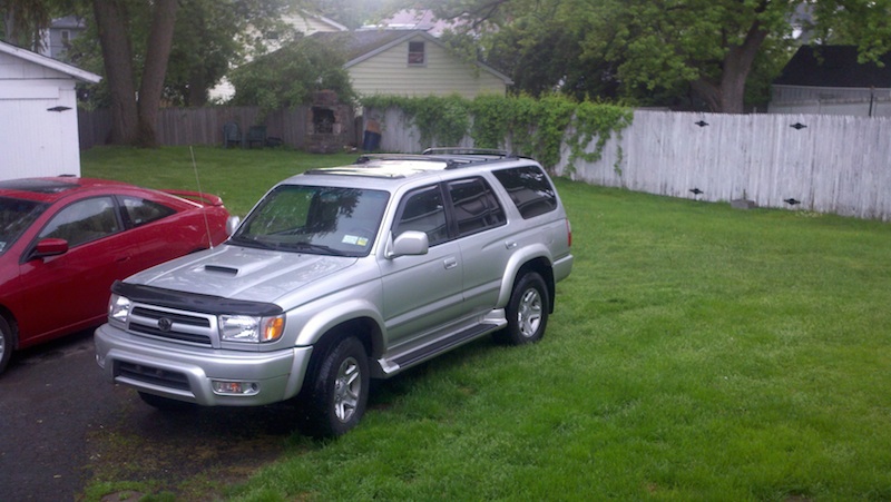

Hello, I just bought a 2000 4runner with 64000 miles on it. I plan on in the next few weeks doing a timing belt water pump all that good stuff. Is there anything else that i should be doing to the truck. I will post pics of the new toy later on.

Wow. Nice find. How much??

I picked the 4runner up for $8500 it was a friend of the family. And she was the only owner.
I was thinking about doing the timing belt only because of the age of the truck. I will also look at doing all the fluids also, before i picked up the truck i did some research and saw all the posts about the tranny fluid and anti-freeze mixing. luckily the previous owner just put new tires on it so i saved myself some money there.
Nice score! I would probably spend the money on all the other maintenance related items first before doing the timing belt stuff.
Beautiful! On our non-interference engines, changing the timing belt isn't usually an urgent / anxiety-inducing gamble. Timing belt breaks, the truck just slows down and stops.
