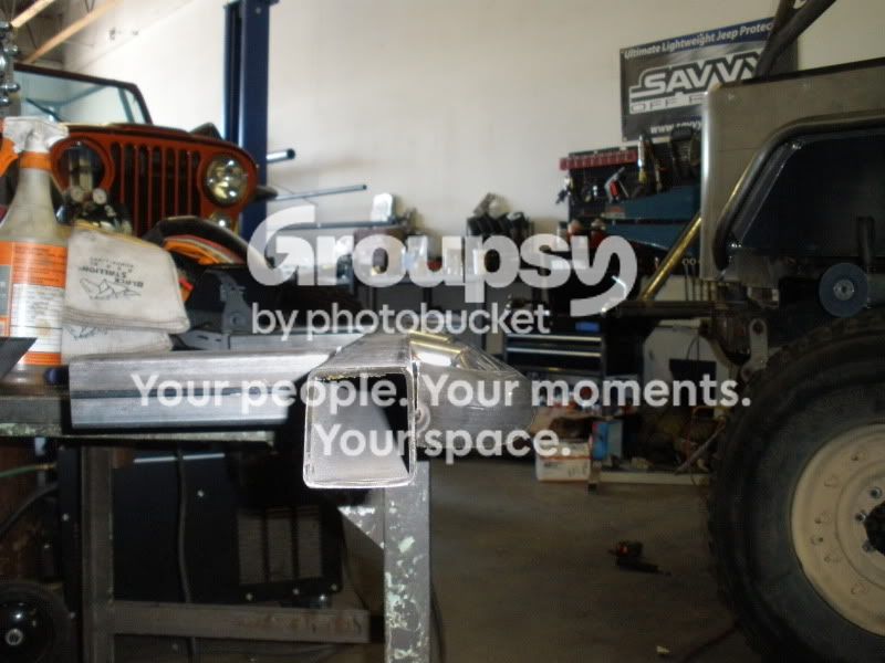

Main body is 2x2 box tube with the ends chopped at 45* so they slide up obstacles in forward or reverse... These will be capped of course

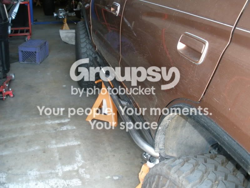

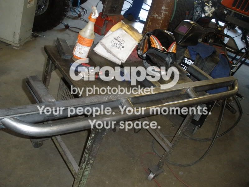

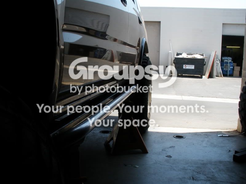

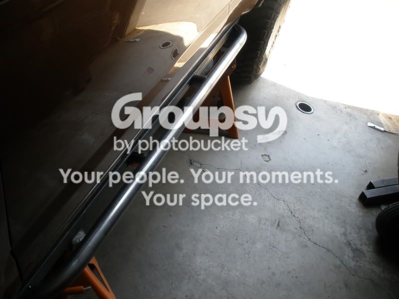

Next we add a 1.75 Round tube kicker... It is wider at the rear to allow for push-off.. They also angle upwards about 12*

I like them, personally though I prefer the look of a slider with a kickout but still a nice set of sliders look very tough
I get what you are saying... I like the function of the kick out but not so much the look... Maybe we tapper the rear a little more out so it does the same thing but visually looks sleek...

How come you only went with 2 inner legs? I think if your going for functionality 3 is a lot better and doesn't really require much more work.
True... There really wasn't a reason :biggrin2:.... So we may just have to add that in on the next sets...
The span in between them is so short that I am not sure it will add all that much to over all strength.. Taking this from past sliders and they were beat on..
