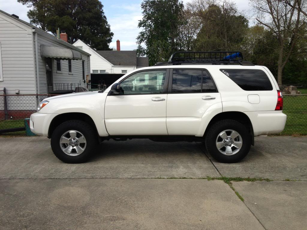

That's what I thought also, but after looking tirelessly at all the other guys running the DS lift, it just seems that mine didn't get quite the same result. Maybe it's just me?

I bought and had professionally installed a ALLPRO lift for my 82 toy pickup. The lift stated 4-5 inches, it was closer to 7-8 inches.
Accessories such as heavy bumpers or winch can add to springs compressing. So can high milage.

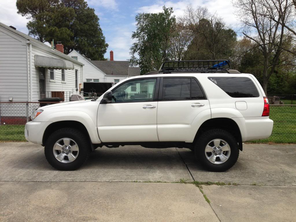

I actually just thought of something. I have some FJ coils for the rear that were sold to me as stock, but I really think they're aftermarket upgrades, just not sure what kind. Here's a picture of them installed with the Daystar spacers. Would 5100's work with this setup in the rear? I could save some money and just get new coils in the front and 5100's?

It looks like you have quite a bit of lift in the rear...I'm no expert but I believe that would work. I haven't looked much into front springs but I believe the OME 884 will give you 3 inches or a little more up front, and then if you have fj springs plus daystar 1.5 rear, you probably have around 2 inches or maybe more rear lift already, and could just swap out the shock for 5100's. I think it would workout nicely..if not you could always upgrade rear springs.

based on the pic you posted, 5100s would be fine for the rear, and 885's would be a good pairing in the front to make it just about level, 884's would leave a little rake
