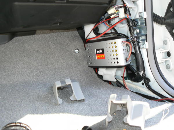

Thanks for the responces. I think the Cross over location may be the problem. The kick panel on the '07 are full of wireing and I really had to fight to get them in and the panel back in place.
I'll get back into it this weekend.
yea that is defff a problem area for electrical noise, your BCM is right above that behind the glovebox too...
Try mounting the X-OVER under the seats or something
