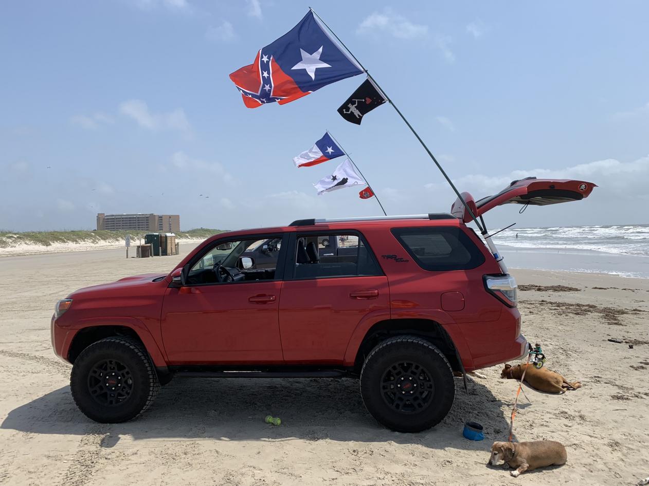

I went with Dobinsons. Still very happy with my choice.
