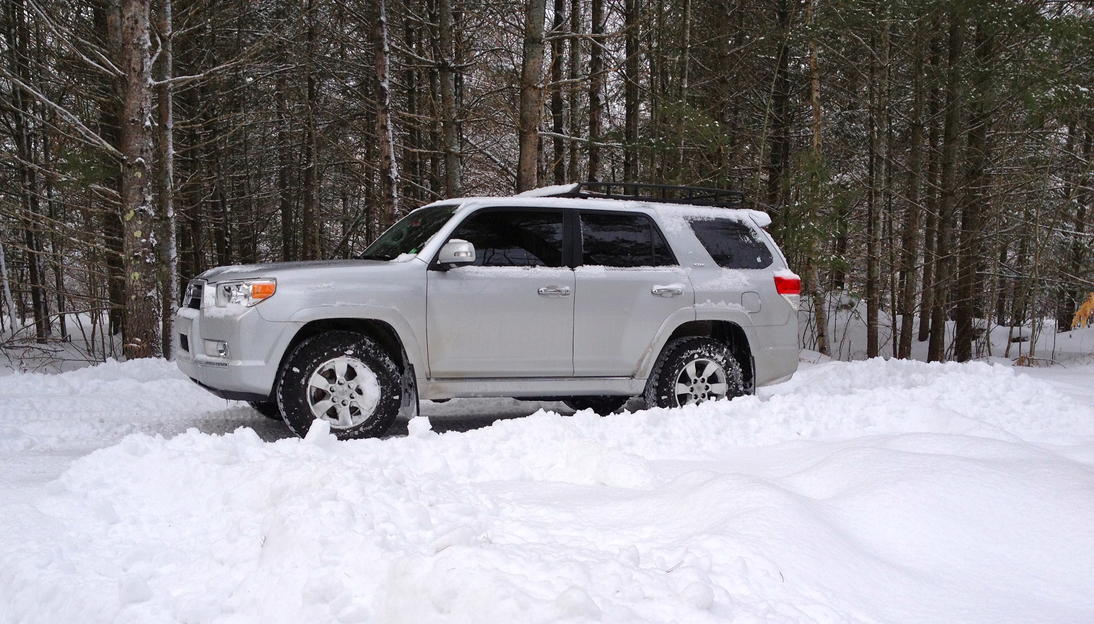

I am partial to the Duratrac's. I purchased a set last winter and now have 20,000 miles on them. The tires are still like new, with very little wear. I live in Michigan and my truck rocks in the snow. No regrets. The tires are fairly quiet considering the aggressive tread design. However, expect some noise, especially as the tires begin to wear. I believe the MT's are going to be noisier.
Hope this helps. Whatever you decide...do not forget to regularly rotate them!!
