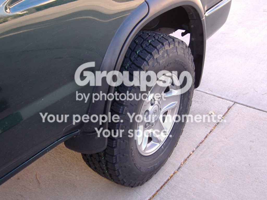

Nitto M/Ts are pretty nice but M/Ts suck on a DD and I'd have to spend alot more time off road to justify an M/T but if my truck becomes a weekend warrior in the next year I might get some.
I like the Nittos and think they look great but they don't offer white lettering which the lettering is only 2nd to the BFGs and I'd sport the white letters out if they had 'em.
Picture109.jpg~original
those actually look good...maybe i would have to retract my statement....although those must be brand new nittos with a fresh tread...
