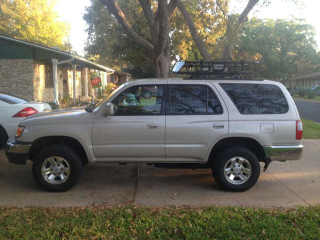

I bought my father's 99 4runner. I want to upgrade its oem tires. What is the largest tire I can install without needing a lift?
Here's a pic. Trying to make it into an epic road trip vehicle!

I think here's the stock size.
225/75R15 102S
Well, do you think, or do you know?
You haven't made it clear what the size of the tires are, that are on the vehicle now. From the picture, the tires look small enough to be the standard 225/75R15's
Is that the size of the tires that are actually on the vehicle? or are you just reading the placard on the drivers door jam?
If you do in fact have 225/75R15's, and want to keep the 15" wheels, then the common 31x10.50R15 will fit. You might even get a 32x11.50R15 on there, but that size would probably rub.

This made me lol. You absolutely can increase the "bad-assness" of the car with the biggest tires that will fit. The 4runner's capacity for bad-assness is limited only by the amount of money in your wallet.
I would stick with the stock 15" wheels, because 15" tires are a lot cheaper. 31x10.5's are a classic size that will look good and be available in a lots of styles for pretty cheap.
You won't be able to upgrade the brakes to the Tundra brakes with 15's. Maybe you were never planning on it, so it's not a big deal. Just sayin' though.
