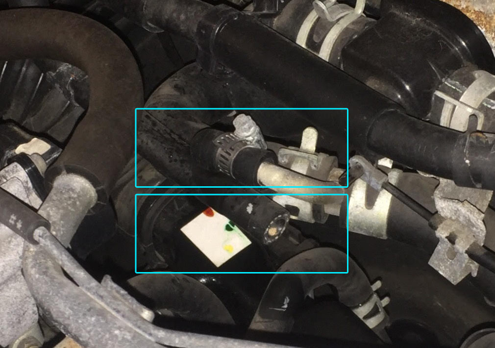

I drive the car some ~500 miles in -5 below to 30 degree weather and no issue. Its been the kind of cold here lately. I am driving today and notice there is some steam/smoke coming from the front. I open it up to find this.
toyota-1.jpg - this is the top rear section of the engine compartment

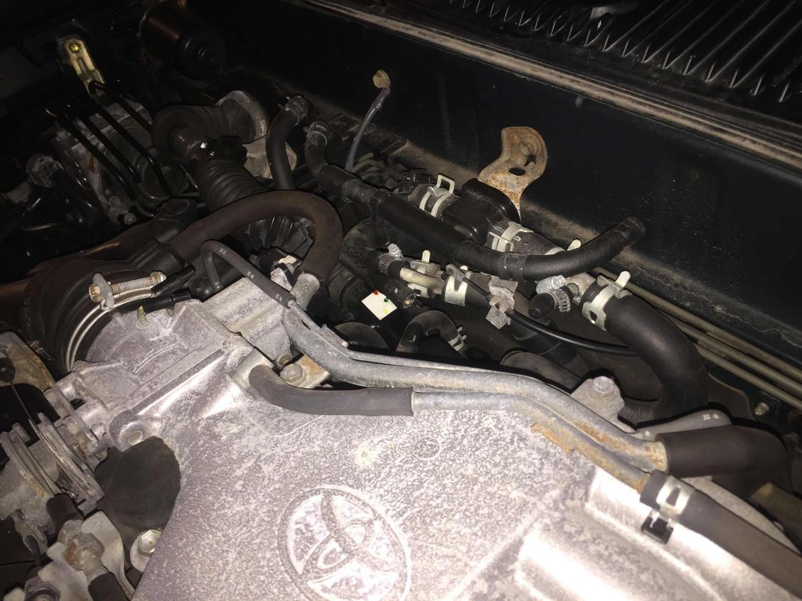

toyota-3.jpg - this top hose is capped. this is dripping clear green fluid (radiator fluid?) out of the end of it at a pretty steady clip. this is running down onto the engine block and creating lots of steam. this bottom section of hose is hanging free. this doesn't look like it was just slapped on here recently.

If I had to guess I would say that disconnected hose goes to a heater core which may have been leaking.
I'm gonna add that this looks like they capped(with one of those cheapo vacuum line caps that sell for 89 cents for five) one of the lines to the rear heater.
If you examine the FSM [EDIT: also look at the parts catalog drawings] you can make a determination about whether or not they did a good job and you can simply replace their cap, or if there might be a better way to handle the issue of the presumed kaput rear heater. The metal rear heater lines are known to rust out in the rust belt.

Get rid of those cheap caps. They can fail and you'll notice you got a head gasket failure.
This is what I would do. Get 1 hose from the removed line and attach both ends to the tubes which are capped. Then bend the hose in the middle with a cable tie to prevent by-pass.
Rear heater does nothing to defrost the rear door window. Also the rear heater is useless. I have a fully functional rear heater (now, disconnected) but it takes about 30 minutes to pass hot air out from its vents.

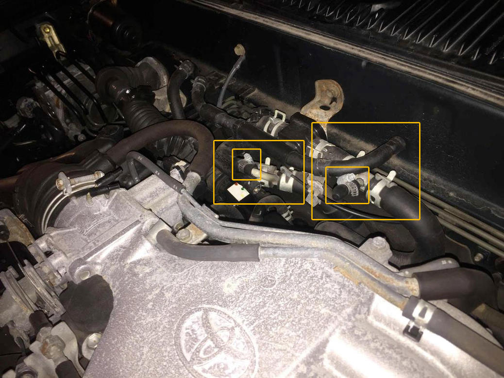

I was able to replace the leaking rubber cap with a fresh one. No more leaking - no more smoke spilling off the engine. Progress.
While replacing the cap I also noticed that there was a second hose that had been capped in the same manner. I attached another picture the post to show this.
A friend put it up on a lift for me and we traced where the empty lines ran. They both drop down under the body and then back into the cabin at the start of the rear. These are most definitely rear heater lines. There is a non-zero chance this is a rust problem. ;)
We're going to take the metal inserts that provide the spouts for these lines out of the equation entirely once it warms up.
