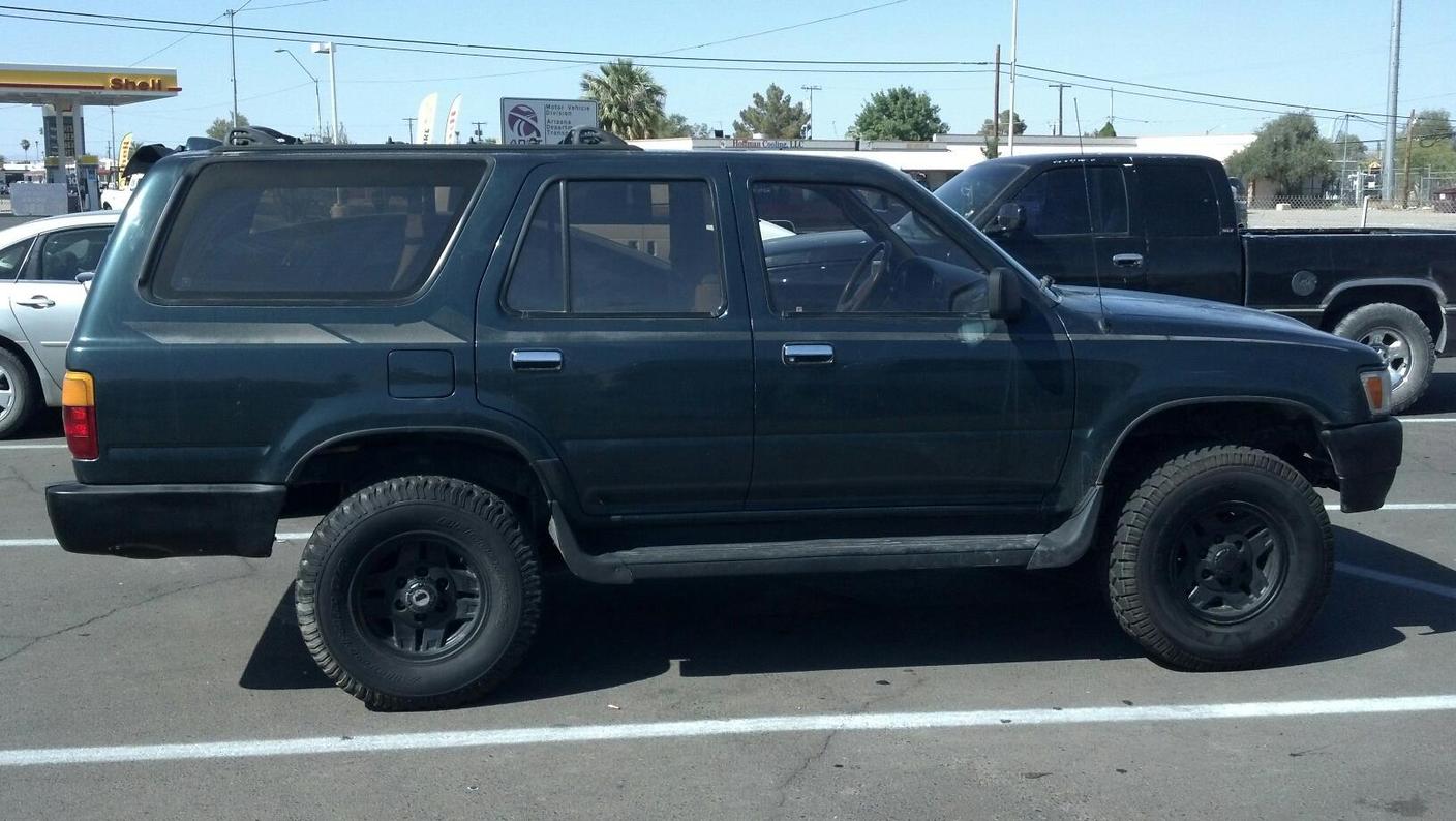

Hello everyone! I just picked up a 94 3.0 4x2 auto it has 230k. I'm new to the 4Runner and excited to get into a truck again. On the way home from the seller i noticed that it has a vibration at 50+ MPH not sure if its the tires or something common that needs to be changed out. Look forward to spending many hours on this forum.
Not too bad for $800 right?

Toyota's have many different vibration issues, do some research with the search function. But start with the balancing and rotation, but make sure the tire place is using the correct equipment. Toyota's need a special adapter to get the rims balanced correctly.
Do a Google search for Toyota rims and hub-centric vs lug-centric balancing.
