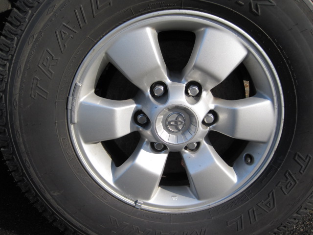

Also, a minor issue but I noticed a slightly larger gap between the metal at the base of the headlight and the front bumper on the passenger side versus the drivers side. I can easily slide a finger in the gap on the one side but not the other. I've noticed this on a few 4Runners...is there a fix for this? eg. adjust the bumper? I've posted a pic of the truck and of one the wheels - I have not seen this wheel on other trucks, does anyone recognize it? Is it a Toyota wheel? Thanks!
Mark
The wheels look like a 4th Generation 4Runner wheel, being from the East Coast definitely make sure the rust isn't canerous clean it off as soon as you can.

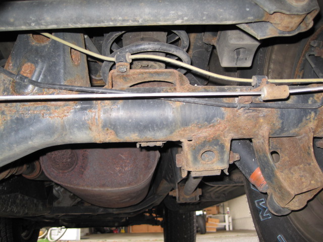

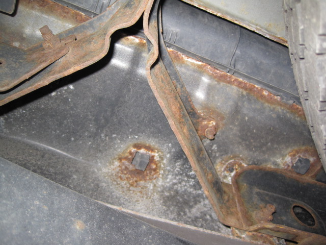

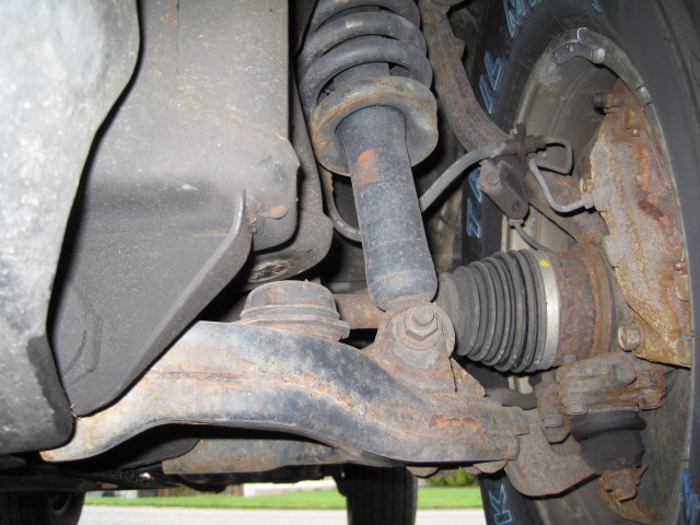

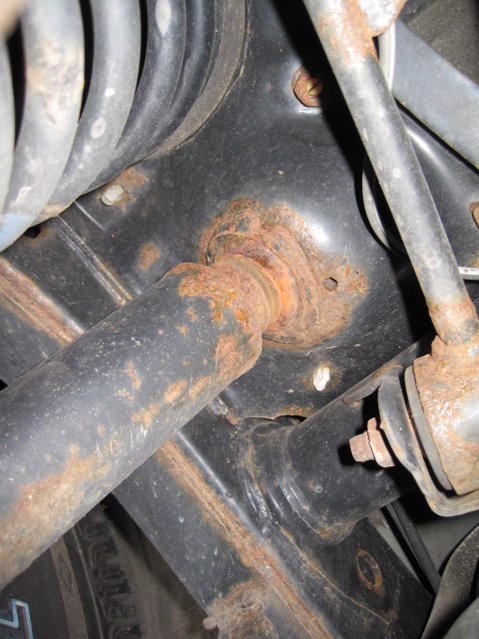

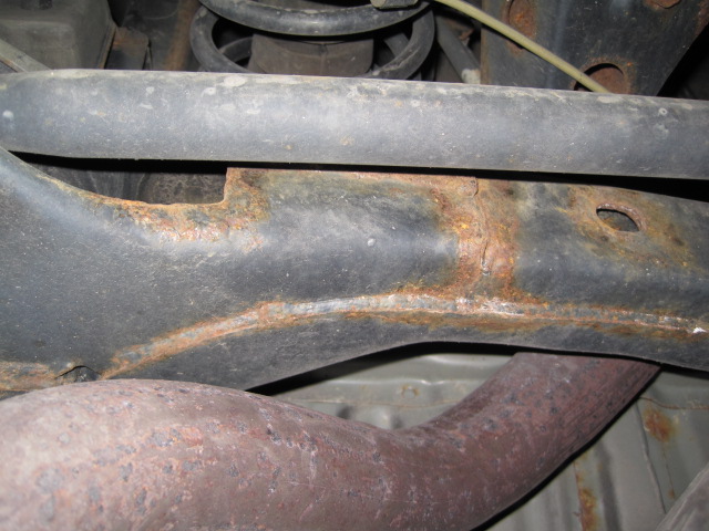

OK, here are some pictures from underneath the truck. There is no rust that I can see on the body panels or in the wheel wells etc. Thanks.

you do need to address this as it will devlop into a problem, but with that said, no one is screaming fire just get ready for some uncomfortable nasty work ahead, bust out the wire wheels and various grits of pads and get to it, remember it's best to remove all of it and coat it rather then just encapsulating it for another time
this one and the rear axle look worst to me, you really don;t even need to do anything for a bit, but still i'd rather be safe then sorry
OK, thanks for the input. I agree the shock mount looks like one of the worst spots to me as well, but perhaps after I go at it with a wire brush I'll find it's not so bad (lots of good steel still there)...or not. Speaking of shocks, these look like originals...when do you normally replace them?
I remember using some stuff 10 or more years ago on the trunk floor of a 69 Firebird - POR-15, stuff you can paint right over rust, it hardens into a black material and is supposed to prevent further rust. It seemed to work well. In this case I will try and remove all I can with a wire brush before applying anything.
I can hardly believe I'm having to deal with rust on an 2002 vehicle! I will say the exterior of the 4Runner looks great, and it drives well.

I just bought a PA rig, too. Mine was a bit nastier underneath than yours..it's a '97. Get what you can now, but you're still in good shape!
That rust doesn't look too bad, I've seen much, much worse! But like others have said, just make sure to address this problem before it gets worse.

My main concern with the rust is the rust at the top of the shocks. Could it get so bad the shock would have nothing to attach to? Sounds like it might be tough to fix! It also looks like an awkward place to get to to remove the rust. The rust on the axle etc doesn't concern me as much because I assume the steel is quite thick in those places. As for the rust on the brake components I could just replace the parts as required.
Would Toyota not design the truck so that any exposed steel parts could withstand significant rust (a lot more than on my truck) without losing the structural integrity of the part? It's a 4WD they must realize it will be used in harsh climates.
That looks nice underneath, i say buy it, mine looks about the same, that is surface, i have seen rusted trucks and that is not one of them, I bought new rear shocks for mine, one of them wasnt atteched, and the other was rusted pretty bad, got a set of Ranchos for $80, i thought i was screwed too but the mounts on mine werent rusted and i would assume yours arent either. If you were pertaining to the latch shocks then those are about $35 from somewhere online.
