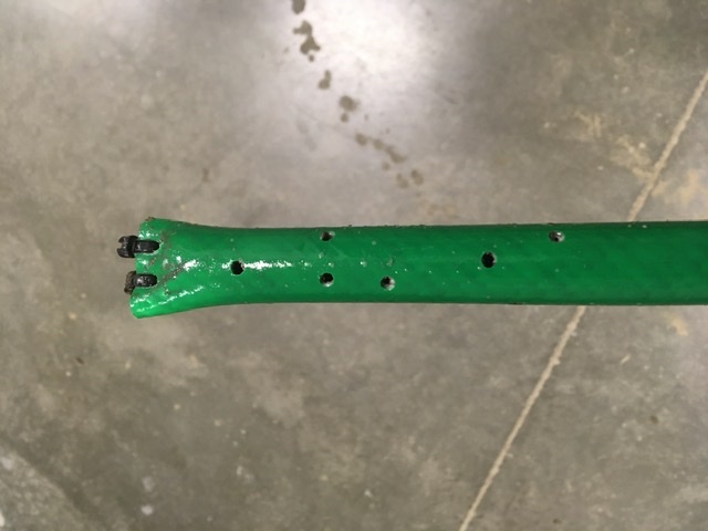

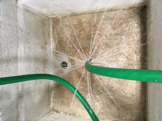

As we’ve been on a bit of a rusty frame kick lately I thought I’d share my new SST for internal frame cleaning. Pretty fancy.
Just run it in from the open end at the back bumper and it’ll snake all the way to the front. Flush away.
If you’ve never done it, you will be shocked how much dirt and gravel comes out the first time. I make it a spring cleaning once the roads dry up. And of course oiling in the fall.
Have fun.

Very nice SST Canoe. Nothing wrong with cleaning out your frame yearly. :)

Great idea, thanks for sharing!
Simple, easy, cheap.......looks like it would be very effective.
Adding to my annual Fall arsenal of rust prevention.

Mine had an inch of dust in the frame when I bought it. I bet others are similar. It took a long time to clean the first time.
