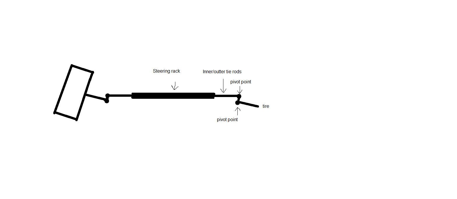

Ok, so sorry for my amature drawing. I dont have any software programs to illustrate this in motion. But the drawing still shows it all.
The pivot points are shown. I only drew the tire on the left side so I could illustrate the geometry easier on the right side. Obviously this is a top, or bottom view, and the wheels are turned to the right.
The steering rack essentially acts as a stabalizer when youre not turning the steering wheel. It helps keep the vehicle tracking straight by holding the wheels in place so that they dont move along their axis. Hence the reason warn out bushing make steering sloppier, because they allow the rack gear to move easier. The line perpendicular to the tire is exaggerated in length to illustrate the point. If you increase the distance between the pivot point on that line and the tire on the other end of it, you create more leverage for the tire to turn. If you wanted to get the steering rack to move easier, you would just put a cheater bar on the end of that line where the tire should be to extend your leverage and it would make it significantly easier to pivot. The cheater bar can be thought of as a spacer because its the exact same principle - they both extend that line.
As a practical example, you hit a good sized pot hole with your right tire. With a shorter distance between the pivot point and wheel, there is less leverage to pull the tire to the right as it digs into the pothole. If you extend that distance, there is more leverage created when the tire hits the pot hole, making it easier to move the steering gear, causing the wheel in reaction to pivot to the right. This of course means your steering would feel more sloppy and handling would be worse.
Sorry for getting off topic op. I just wanted to illustrate my point. And I think its valuable info as it relates to handling.
