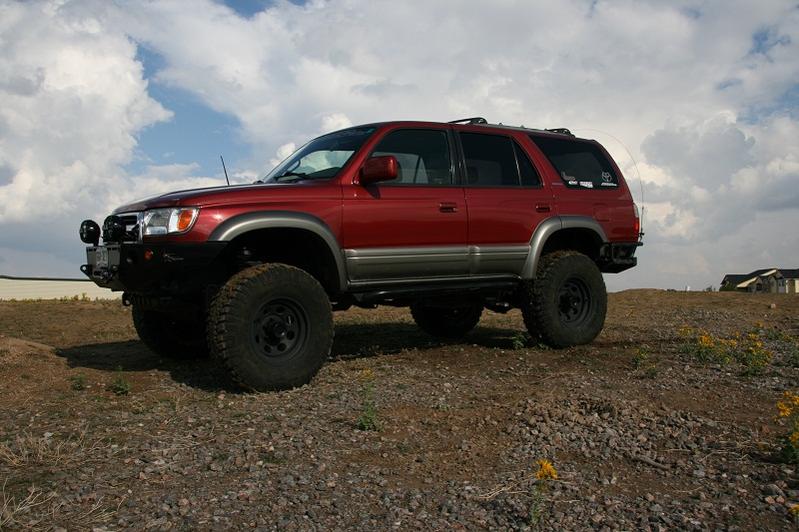

Here is a pic of them install in the 4Runner. This truck has our front coilovers set at 3.25 inches and has about 200lbs in the rear
