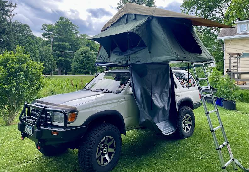

New roof rack coming to properly support the new to me Thule Tepui tent I just got a ridiculous deal on.
