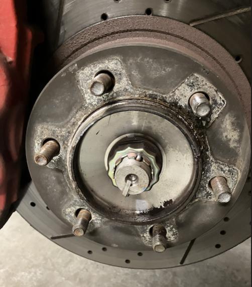

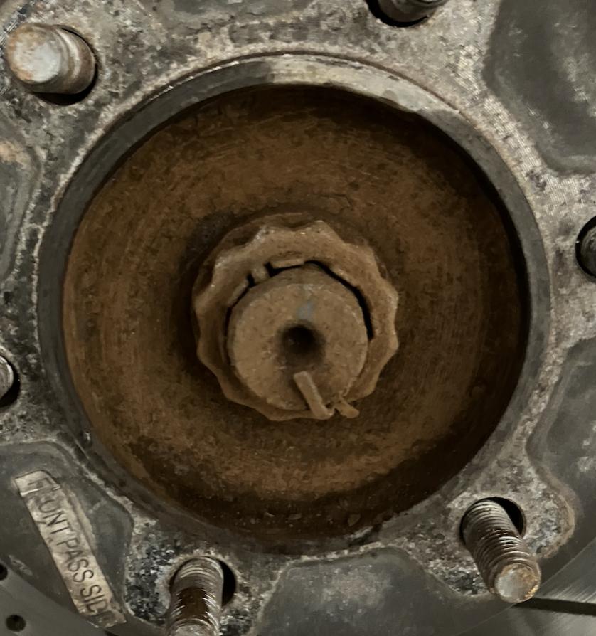

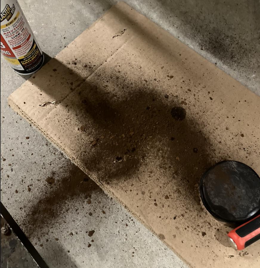

This is my first time messing with the axles on this vehicle (2001 SR5). I started with the driver's side and everything looked perfect; so shiny! The passenger side however, so much rust!!
I didn't notice any issues with the wheel bearing while driving. My question - how concerning is that amount of rust? What should my next steps be? (I already will be visiting the local dealership for some parts today...
pics attached

My initial thoughts are you had a bad "seal" on your dust cap. It doesn't really have a seal, but maybe yours was compromised somewhat and didn't seal as well as they normally do (other side). I don't think you should worry, how did the axle look when you removed it? Maybe put a thin coat of RTV around dust cap lip when you reinstall.
if water got passed the nut for the axle ya its a problem, you will be able to see if there is rust inside the bearing once the axle is out.
Axle looked alright, and the bearings/seal on the knuckle were shiny and all good. I took advice and RTVed the cap when I replaced. I think all is good. Will find out!
