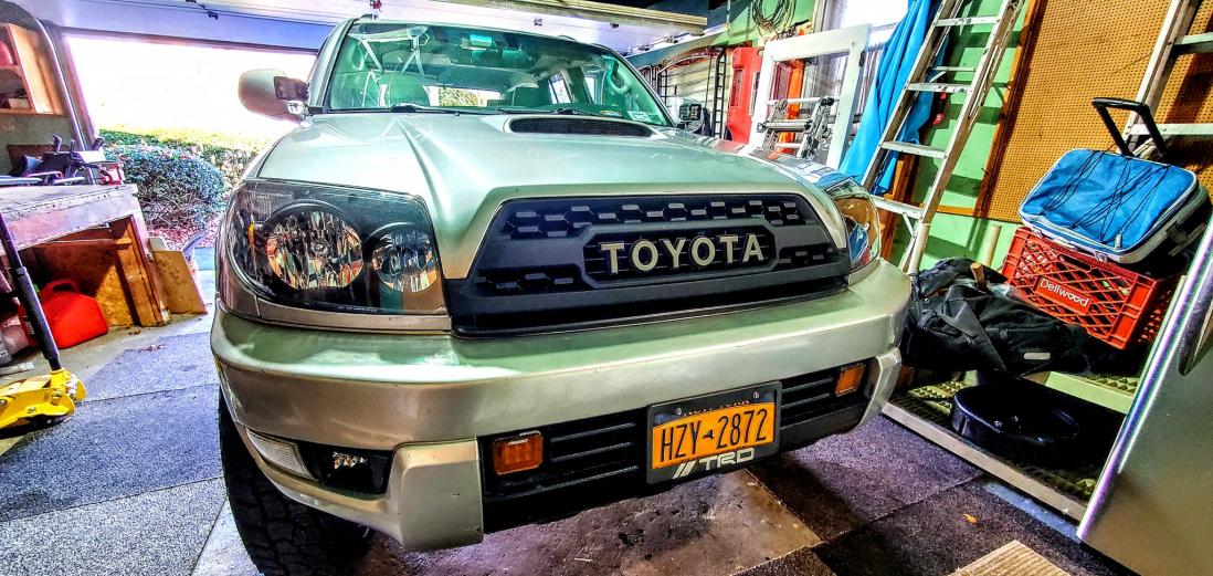

Finally got it in a few weeks ago and color matched it.
Oooo I might try this, Would love to see it on the truck
Ok you got my attention now. Didn't care for a all black grill on my white 4Runner, but liking how good your color matched one looks. Looking forward to see how it looks on the truck.

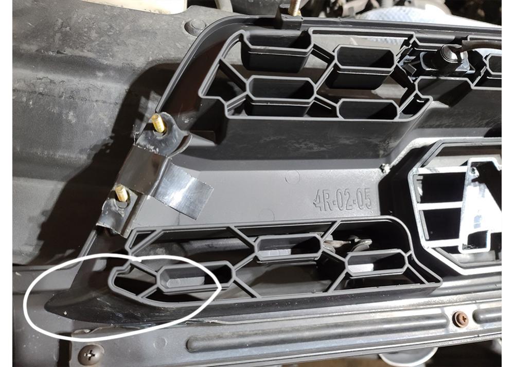

Finally got around to installing the Grill..
a few notes:
1. The old Grill fastener pins don't fit great into the new grill, took some playing with to not crack the plastic where they go in, wd40 and plier helped. But the alignment was fine once they were in.
2. The Grill support needed the corner tabs bent inward slightly and the side mounts bent flatter to line up and seat correctly. A little bending and it worked fine, no need to trim.

For 2003-2005
You need to bend the metal reinforcement or cut the corner. See my pic. This is where you need to cut.
DO NOT INSTALL WITHOUT METAL PIECE.
The hood lever bolt will cause fatigue and break. It is flimsy plastic compare to OEM.
Now it is rock solid.
FOR 2006-2009 it doesnt require any adjustment
FOR 2003-2005 either bend it cut it. Took a total of 10 mins with angle grinder.

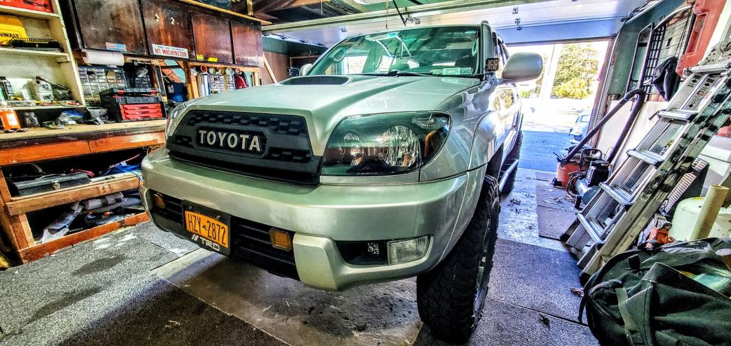

Here's mine
I bought mine from Alibaba. They forgot to send the center with the letters initially but I did get them a week later after I notified them (they come with silver letters from Alibaba) ... I ordered black letters from Tacoma Lifestyle (perfect fit, they're all the same) and chose to go with those vs the silver.
Looks the business.
