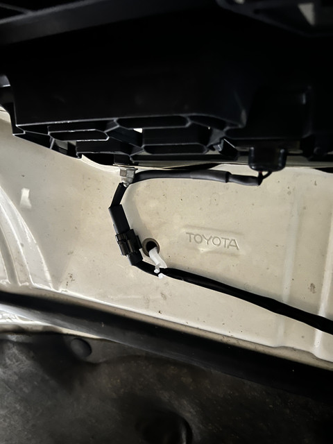

Here's the pics for the wiring on the lights, I used these Christmas lights clips I had laying around to hold the wiring and to keep it from showing from the outside. Also used zip ties to keep the excess wiring from sagging down.

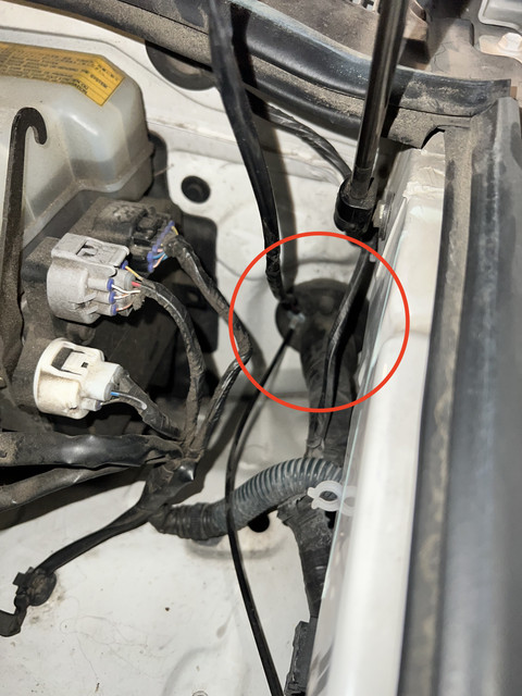

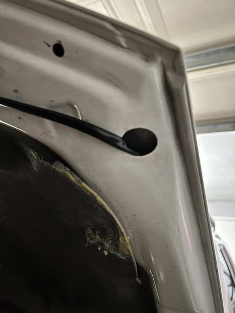

I used a metal shirt hanger to fish the wire through the hole thats at the very corner of the hood to thats further down (I wanted to go through the heat shield but you can see its almost breaking apart from me barely touching it), I had to zip tie the wire to the hood lift support (wire does not get pinched when opening or closing)
I also used the metal hanger to fish it through the firewall (circled in red), I originally wanted to tap into the fuse box thats under the hood but everything I tried kept the lights on even when the car was off.
You went the extra miles with running the wires through the hood, I just ran mine behind the heat shielding and down to the hinge and then like you through the firewall into the cab on my stock grill with lights. Koodos :cheers:

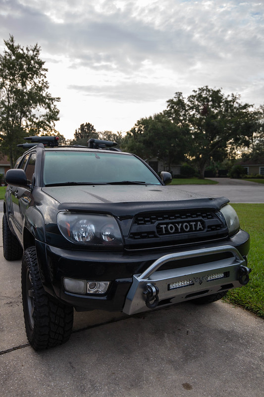

Got it installed last night, had to trim the metal bracket and bend the arms a little to get it to line up. It definitely sits really snug with he bug deflector cause its got tabs that sit between the grill and the hood. Going to trim the wiring harness for the lights shorter and put connectors on it so it plugs right into my harness for the old lights.
Looks good! Now I caught the modding bug and now I'm looking to upgrade my suspension. I really like your setup.
