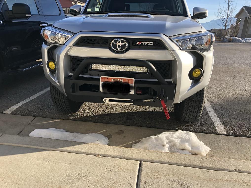

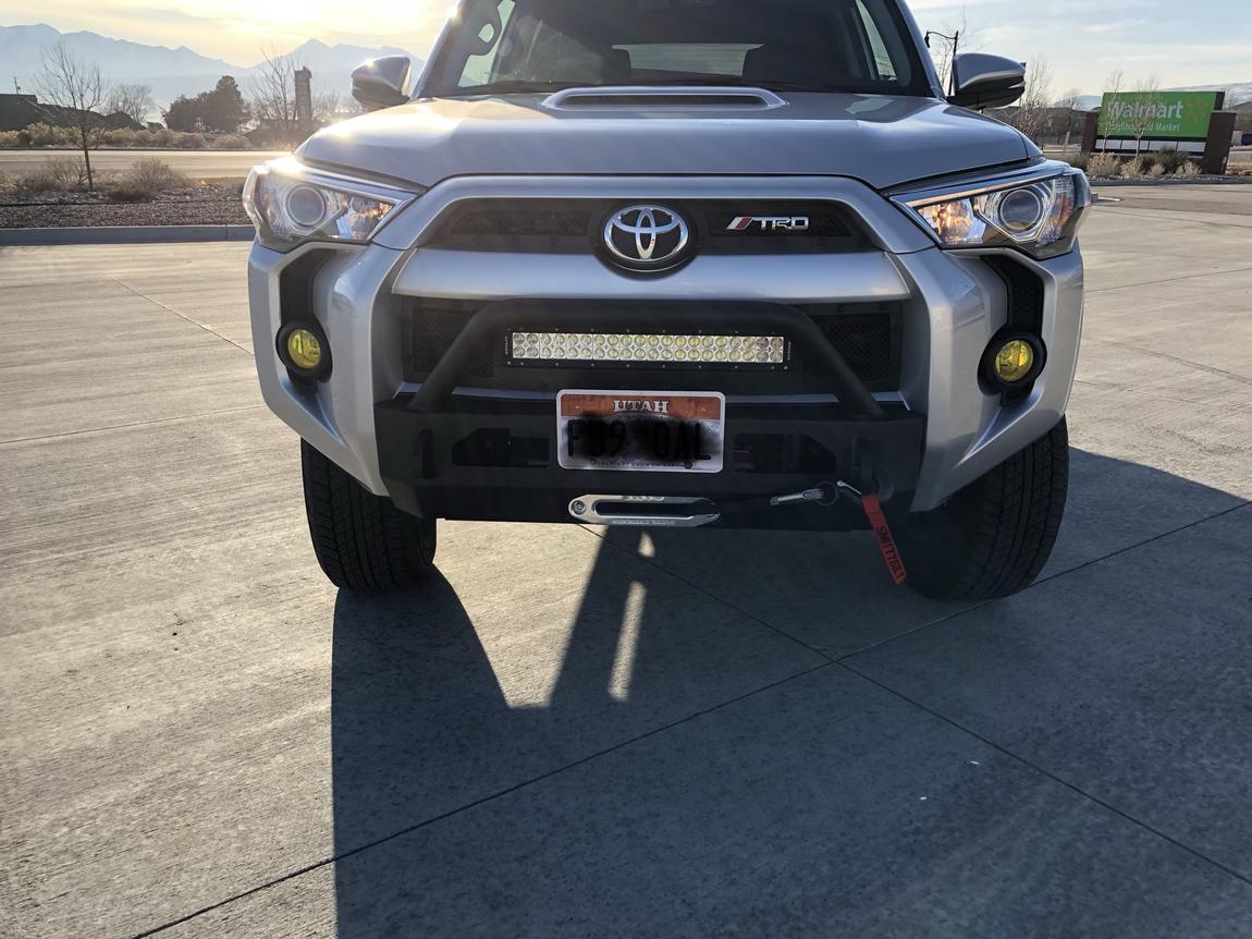

Warn Bumper and SmittyBilt Winch Installed
I had my Warn bumper and SmittyBilt winch installed yesterday... yes i HAD it installed.... don't hate on my for not doing it myself :hunter:
I like the look, and the two fit great together, no issues..
The 4Runner does ride a bit nose heavy, which is to be expected, i think combined weight is 100lbs (ish) But I have an OME medium suspension that will compensate.
I had a light bar already in my grill and the bar does not interfere.
So far I really like it!

Looks good! Thanks for pics. The OME suspension is already on? Can you take some pics of the gaps you have from bumper to plastic?
Looks great, I am doing mine on Friday of this week. They had no issues with the winch solenoid pack on top of the winch or did they side mount it? I am using the same winch.
yes, the OME lift was installed last month, although i have NOT added bigger wheels/tires yet.

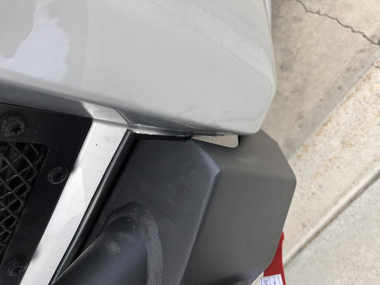

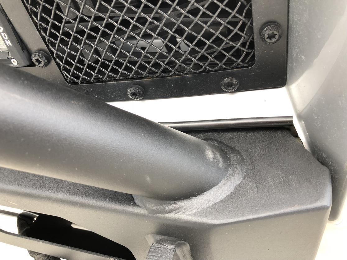

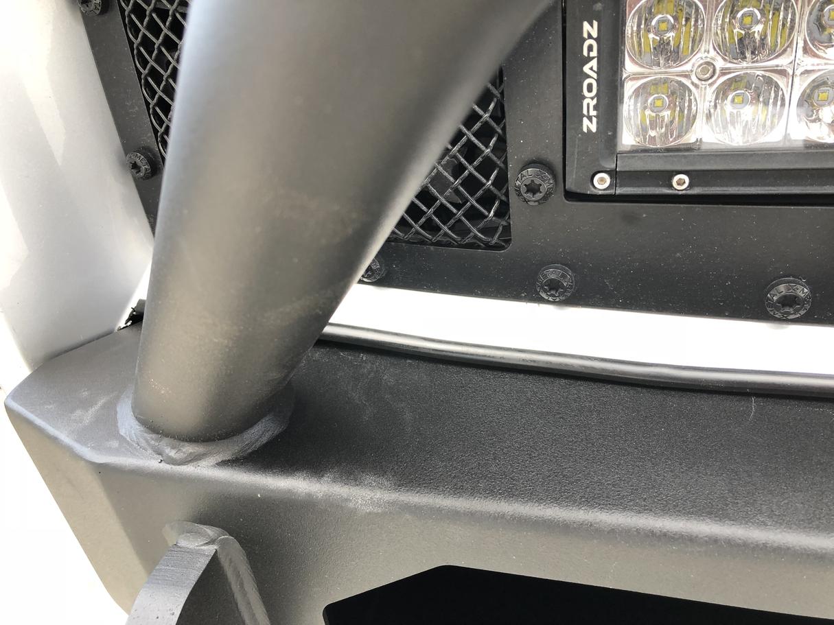

i didnt like their cutting on the sides of the plastic where it meets the warn bumper, but i will go in with a file or sander and clean that up.. One thing they DID do that I really liked was they added a plastic trim piece on top, where the warn bumper meets the plastic, that looks much more clean.
maybe something you should ask your installers to do for you. im sure cost is negligible and covers that long top cut they have to make... see pics...

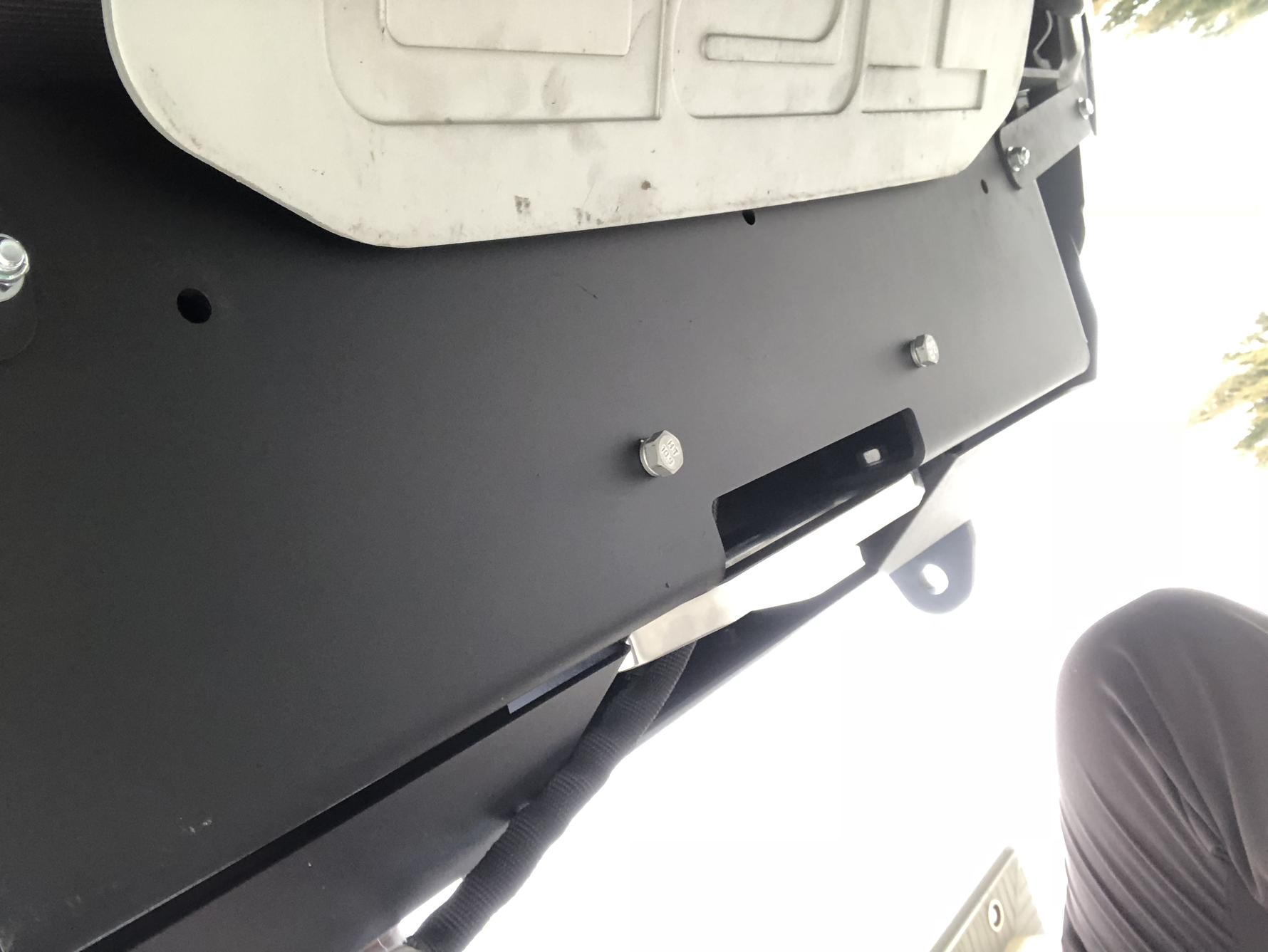

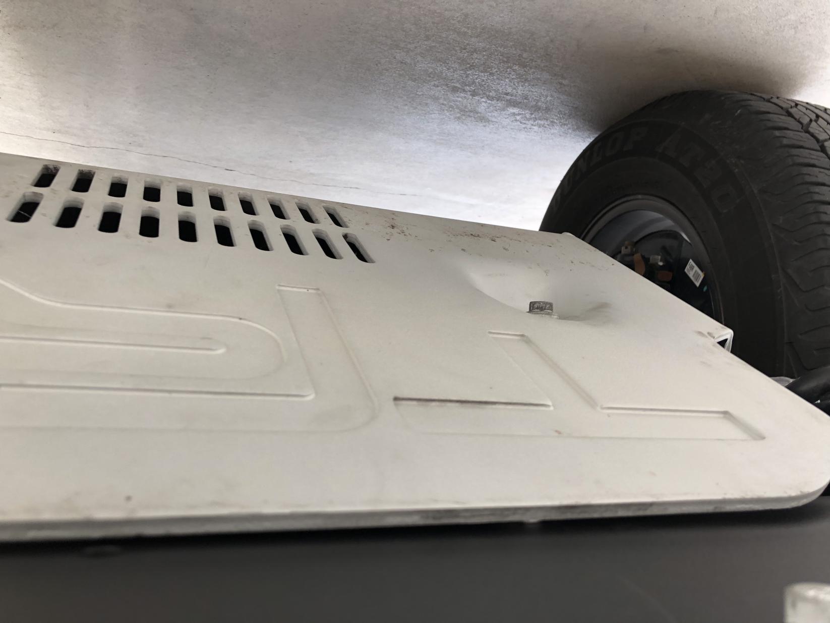

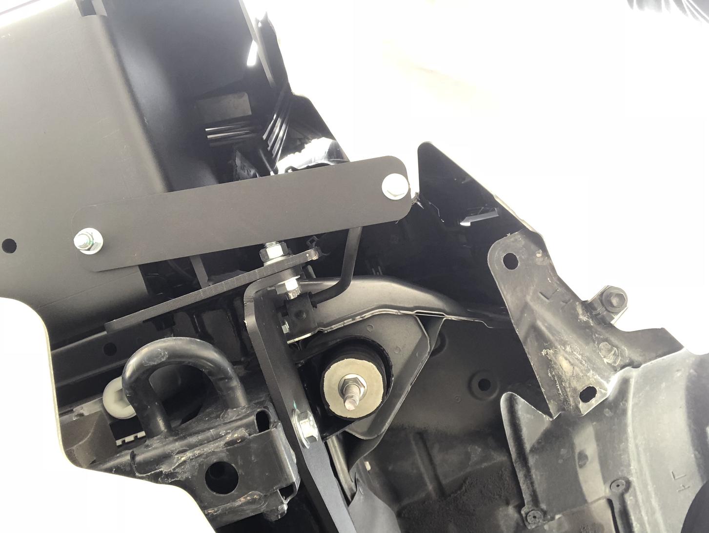

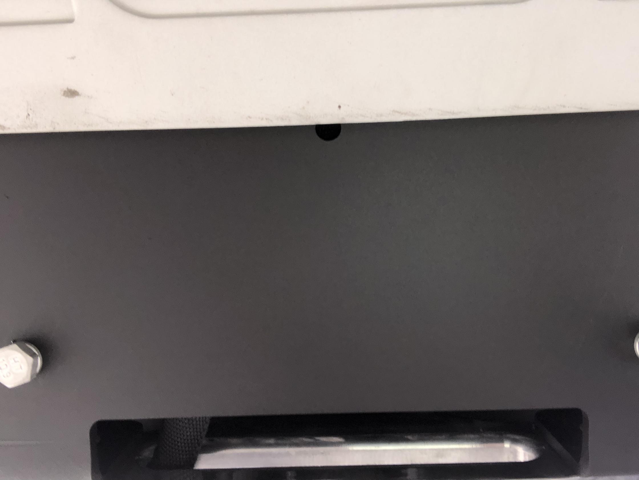

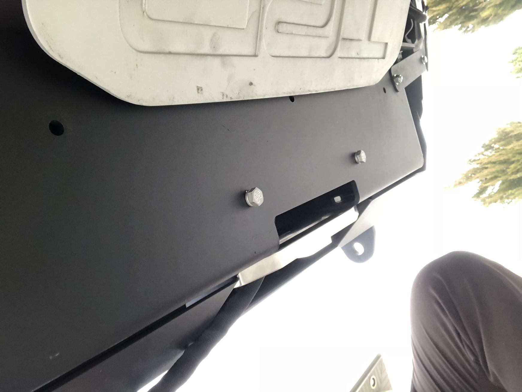

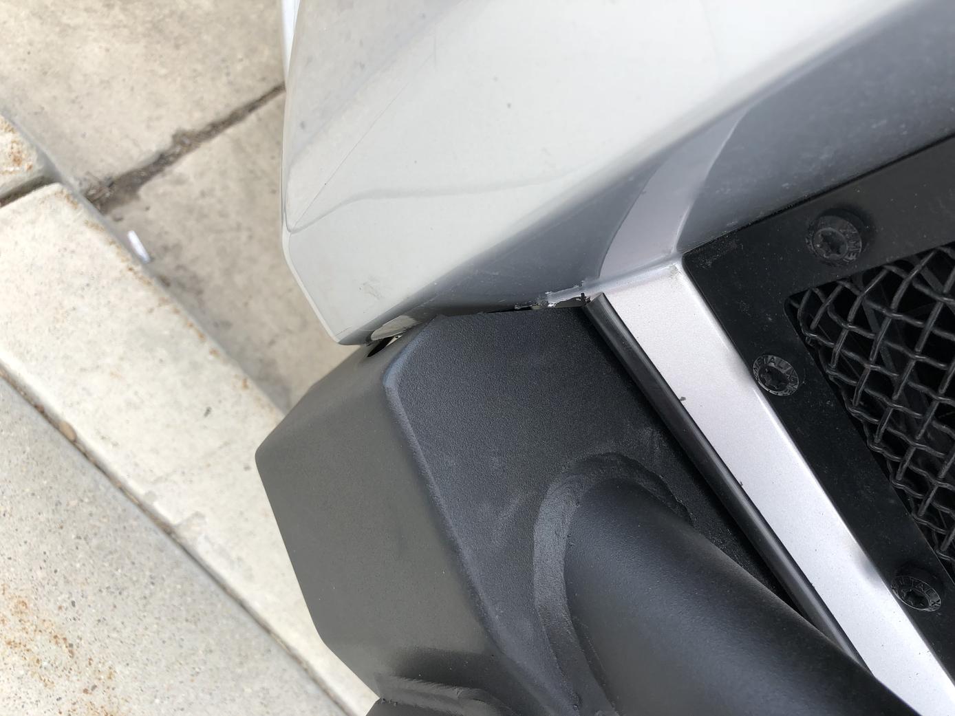

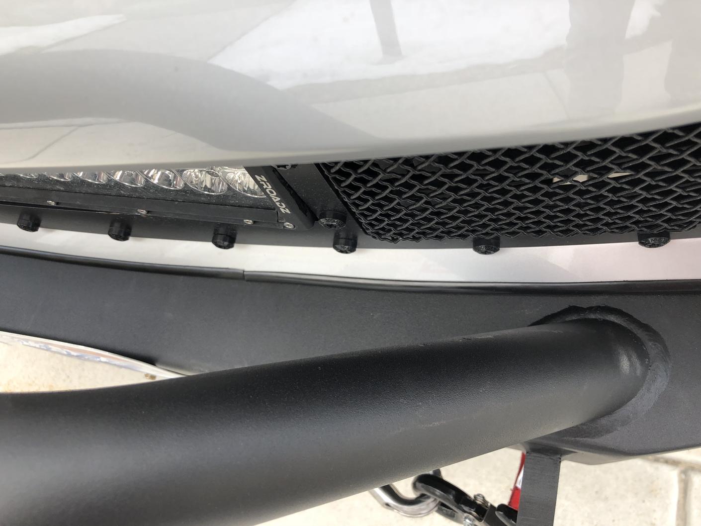

[MENTION=199747]Greensleeves[/MENTION] Did they secure the factory bumper to the warn bumper with part A5 from the installation instructions?
[MENTION=199747]Greensleeves[/MENTION] You’ve got the trd pro skid? Can you post a front on pic that shows the clearance from skid to bumper?
Here you go
The braces seem....In-elegant. How about some stovebolts or rounded allens? The less stuff to snag on the better.
