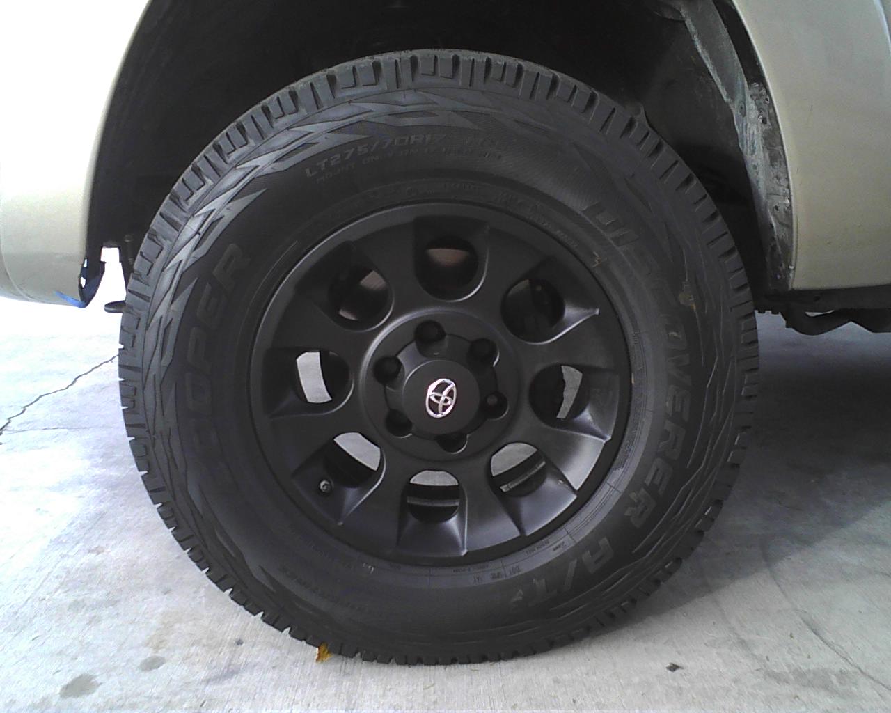

Honestly not that big of a deal , unbolt from old get the kit for each wheel little under 8$ called fitting kit 2 new gaskets & stem be careful not to over-tighten rolling ! Takes bout 5 min. a wheel these were just pcd put the old sensors in spare is old one
