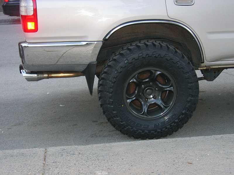

Okay just got done painting one of my new Sequoia 17's, here's my concept:

those look SICK! How hard is it, i gotta know cause i officially wanna do that now ... soon. And, will it stand up to conditions?
Painted Wheels w/ 285

yeah i used the zinc primer...2 or 3 coats...then i sprayed the red lips, like 3 or 4 coats....let it sit a couple days....then taped off the lips and sprayed 4 coats of semi gloss black, let it sit a few more days, then 3 coats of clear....i think i added an inch to these things just in coats of paint hahah
