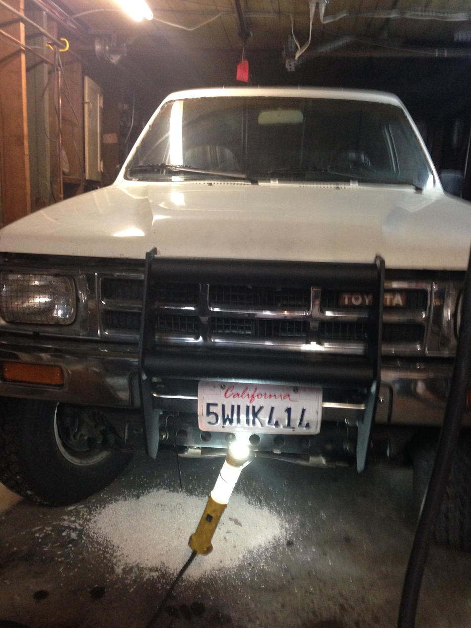

did you find out where all the coolant blasted out from?
the hose coming from the water pump apparently busted.
i got semi tinted lexan, so im hoping that helps with the yellowing..
found a bull bar on cl for forty bucks and swooped it up. put a coat of primer on it and painted it with truck bed liner.
