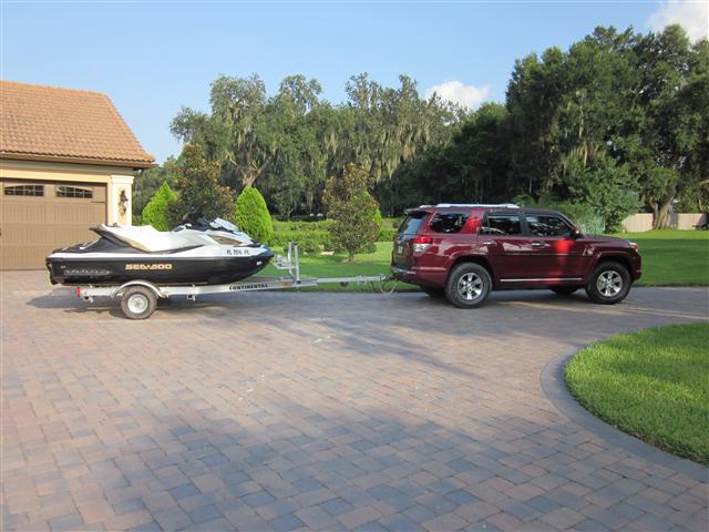

As to air bags mentioned by Antman, good things to have if needed. I went another route because the most I will tow is about 4k. The jet skies I have with trailer is right at 3K and I have no sag. See photo. I have an SR5 with no aftermarket shocks or springs. Seems just fine. I have not towed my other boat yet which I estimate at 4k, when I do, I might have to go with Antmans route or what others have done with stronger after market shocks.
I know it's new, a little scary, but do not let it stop you. Axxmans advice regarding being smart when towing is great advice. Take it easy, keep your eyes out all around you and especially in front. Give PLENTY of room to stop, you will have extra weight behind you when braking, it WILL be different.

The amount of sag you get will be determined by the tongue weight, which I bet is not much on your jetski setup. Just an observation :D
