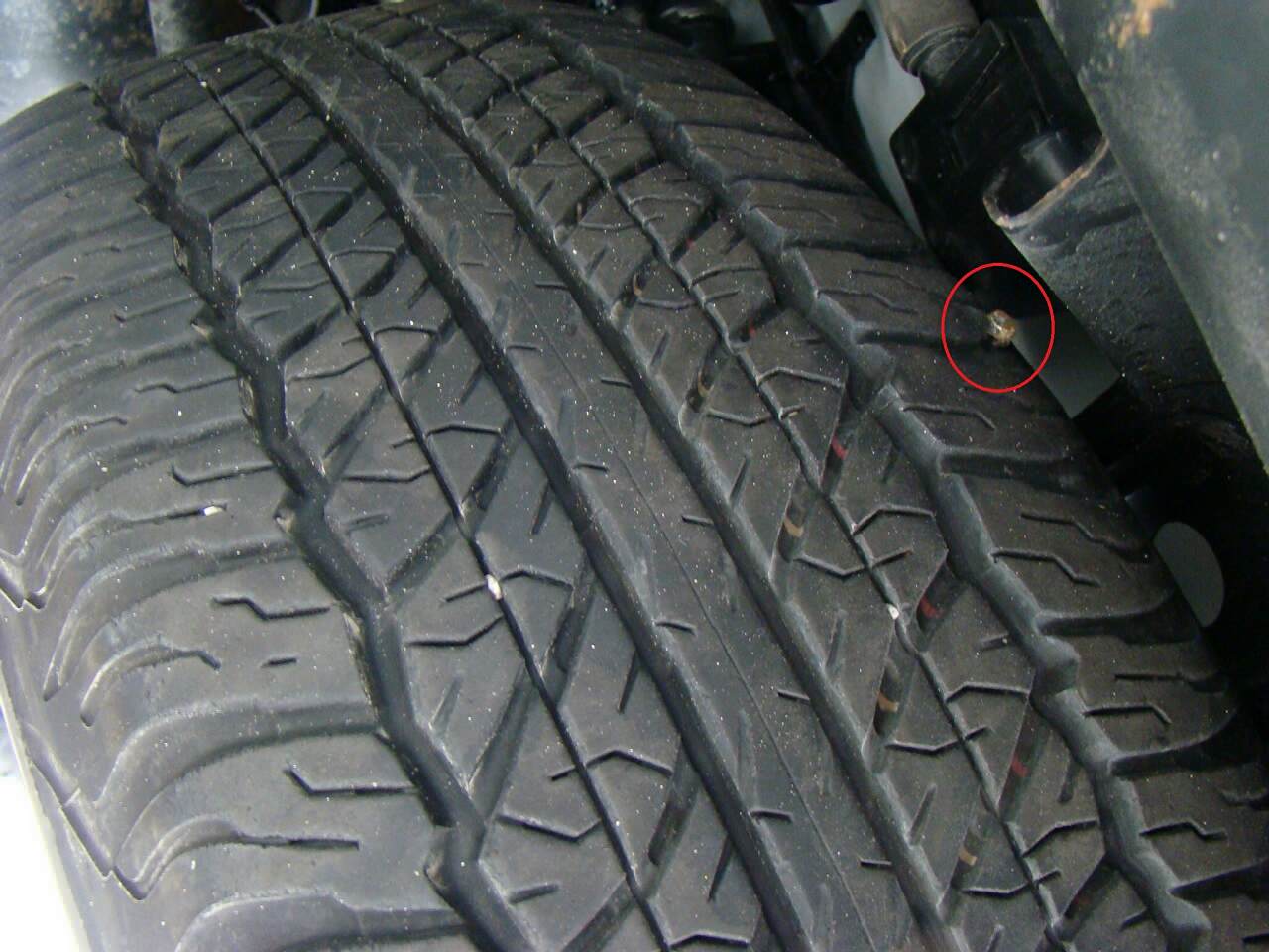

A screw was in the tread but was less than 1/2 inch to the edge of the tread area (I mean, when you stand the tire on the ground, and look directly facing the treads, the screw was close to the edge but not on the side).

I have taken a picture (attached) of where the screw is, and it seems the puncture tire (mounted under the trunk) is unrepairable, right?

That's what's called the shoulder of the tire. Most places won't patch a nail in that spot (including myself). That section of the tire flexes the most so patches don't hold well.

Tomorrow I am going to order a new tire from the dealer. Do you think I should use the new tire instead of the spare tire? Can I ask the dealer to check the rim for the punctured tire?
You can have them check but I very much doubt there will be any damage to the rim. Just driving on a low tire will not hurt the metal. I generally run lower pressure when I wheel and I haven't hurt the rims yet.
Your spare should be the same as the rest of the stock tires, all 4th gens come with a full size spare.
So what you should do is have that tire patched if possible and use it as a spare.
And I seriously doubt you damaged the rim at 22psi, I go off road at 18psi and I hit much more extreme obstacles and turns with no damage.
No problem Chee,
Unless the dealer is giving you a good deal, I dont think its a good idea to order a tire from the dealer. (they charge too much $$) What I would do personally, is replace(or patch if you can) the tire with a screw with the cheapest tire you can find and use it as a spare instead.
Don't worry too much about it... You'll probably never use the spare anyways.
