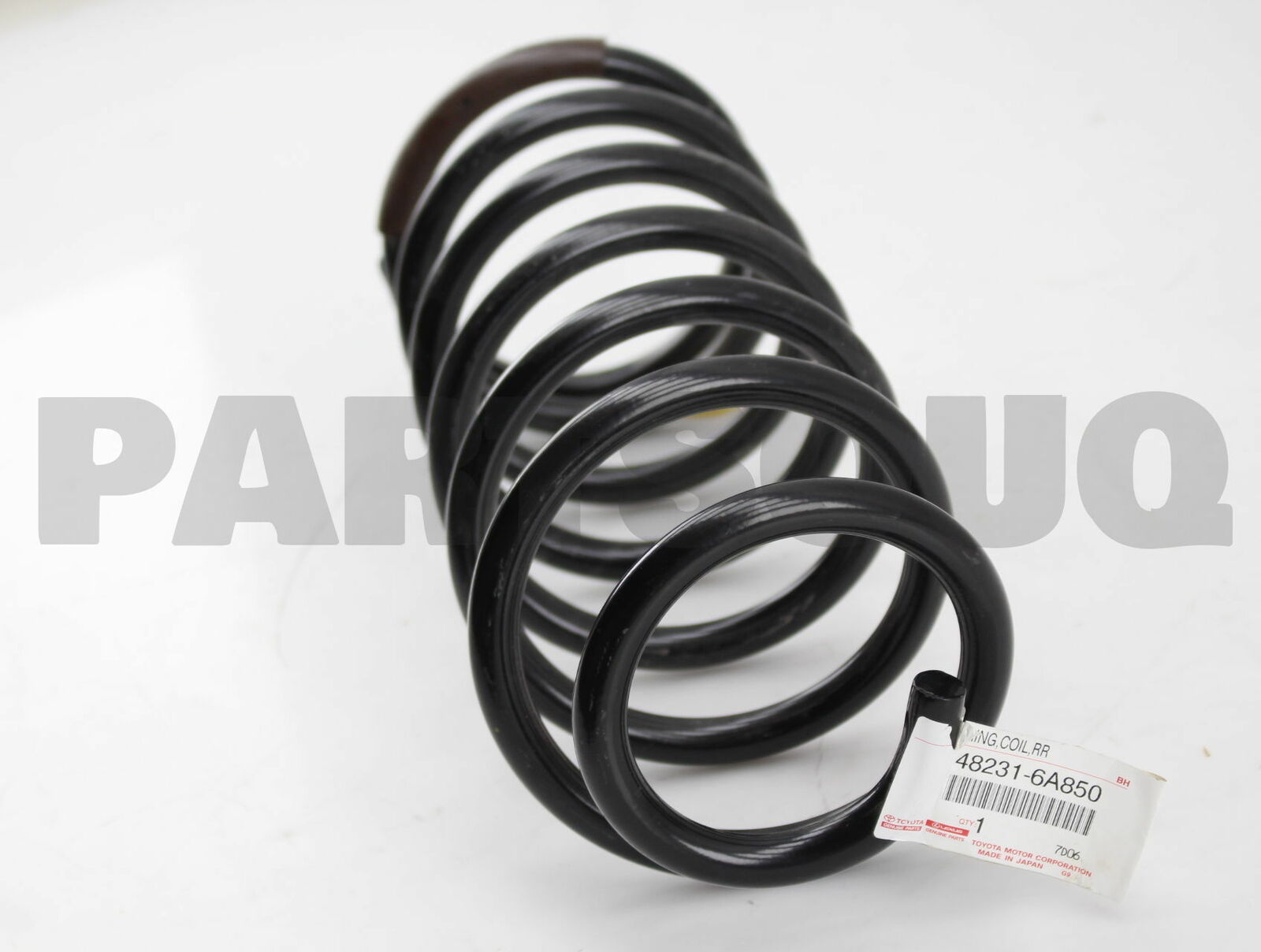

I just replaced a set on a 3rd Gen.
The new ones were OEM from Toyota Land Cruiser 90 series Prado.
The part number is for a Prado with a third row seat and a sub tank (same tank that they fit on the 3rd gen 4Runner).

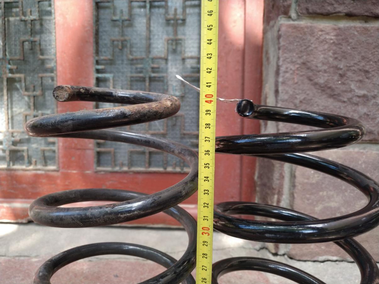

The prado coils are 1mm thicker than the original 4R coils and the 10mm shorter. But height was not changed after replacement.
Part number is 48231-6A850. Hopefully they last a 1 or 2 longer before they sag again. I bought them for about 132$
  • 0-02-0a-8e313b335e388db09b853beef33498e9dcffdc8b8f2107f53d7b592e107f7538_88a4fae91cc57433.jpg
